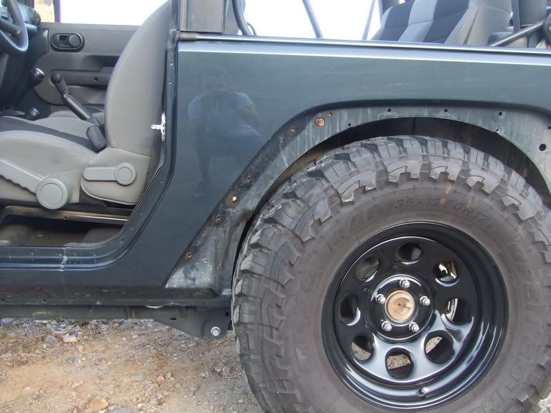

If he is rubbing his rear tires, he needs to trim or fold over the pinch seam at the front end of his rear fender well. Or, his kit may not have included extended bumpstops--so he needs to buy some.
Here is a pic of a tire rubbing the rear pinch seam:
Here are pics of a guy who trimmed his pinch seam instead of using a BFH to fold it back:
I folded mine back. If your buddy trims his, he should consider either using JB Weld or something else to close it back up. He at least needs to paint over the bend or the cut to deter rust.
