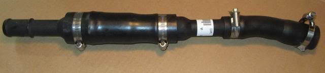

Here is a pic of the updated part they are installing now. It's a filler tube with a check valve in it. Look under your brother's and your friend's Jeeps to see if they have this installed. (I'll guess they don't)
Anyway, it's an easy and inexpensive fix to do it yourself. Some people have made a short video of the issue on their Jeeps that were not covered, and their dealers went good for it.

This. A few months ago my 10 Rubicon started to slightly spill at times. I mentioned it to the dealer and they replaced the fuel filler tube as stated and they did it as "good will". No charge.
