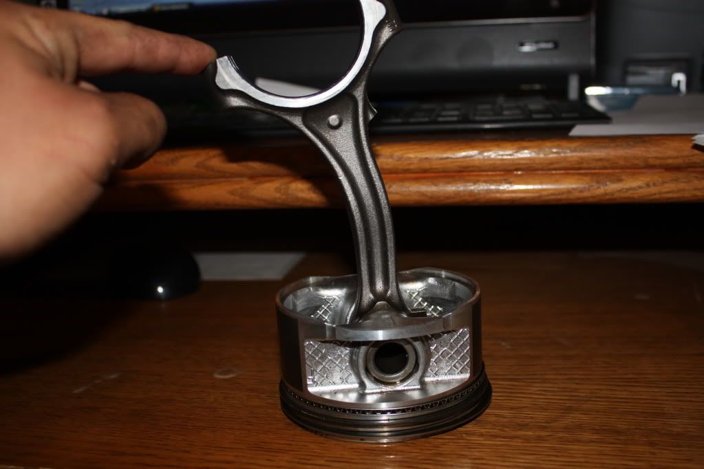

Posts: 335
it was right around 1000 bucks to get it fixed, i bent number 5 rod. i didnt even bother to go to the dealer because i knew they wouldnt fix it and i didnt want to screw up my lifetime warrenty. its also fun to call around to parts stores and say you need a rod and piston for a 2010 jeep, i had many oconfused comments on that one. i have since installed a river raider snorkel.

TheStigX
Location: South Jersey
Posts: 1,370
That is a great picture kking. Its like a trophy!
