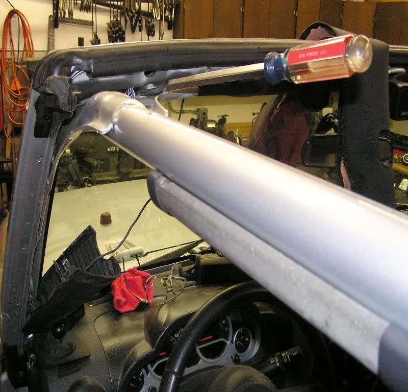

Update: I retrieved the key.
Thanks to 2jk1cjtj for suggesting on letting the windshield down, thatís exactly what I did. Once down I was able to get the key out, but not before almost pushing into no-mans land. Anyhow, here are some pics for those that are not quite sure how to go about it. I didnít spend a lot of time composing my pics because it was so hot in my garage. By the time it was all said and done my tee shirt didnít have a dry spot on it. Oh, also forgive the dirty pics, I hadnít had a chance to clean my Jeep yet. Did lots of off-roading this past week.

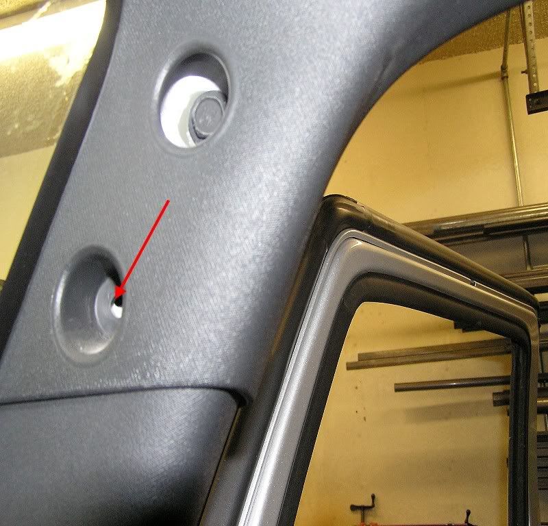

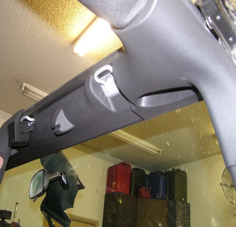

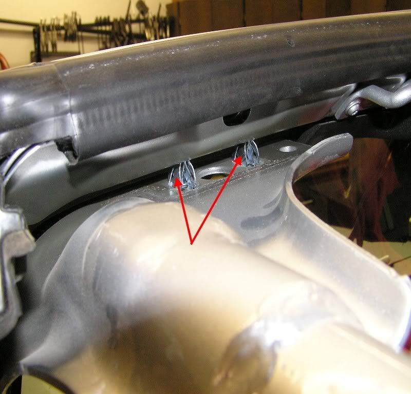

After removing the top panels if you have a hard top is to remove the visor. #20 torx

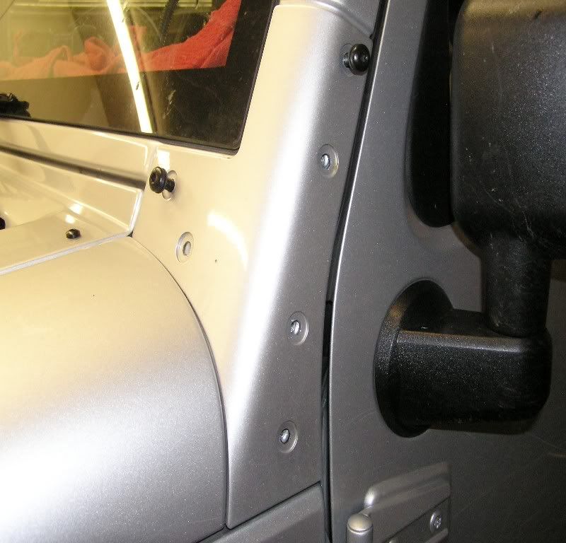

Next remove the trim screw and push-nut on the top pillar and then yank the trim piece off. Be very careful and make sure you put some rags over the gap before you start. This pic shows the screw removed already.

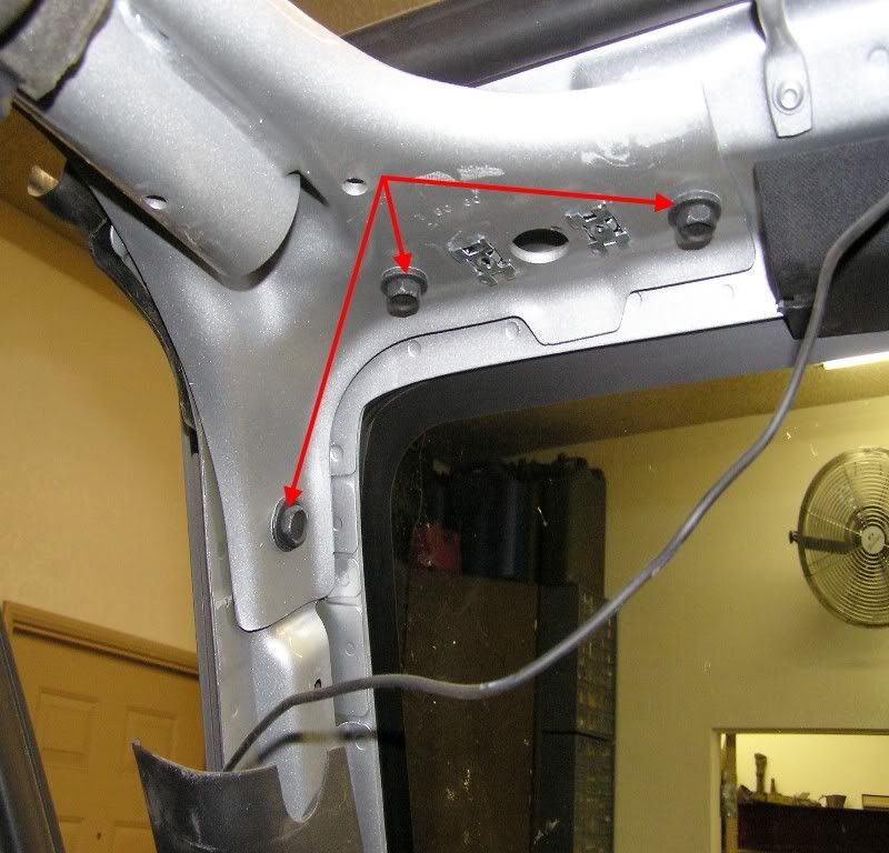

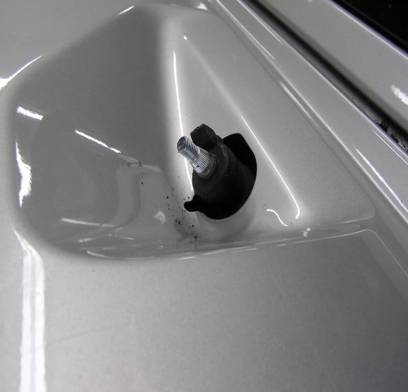

Then remove these three bolts. They are 13mm.

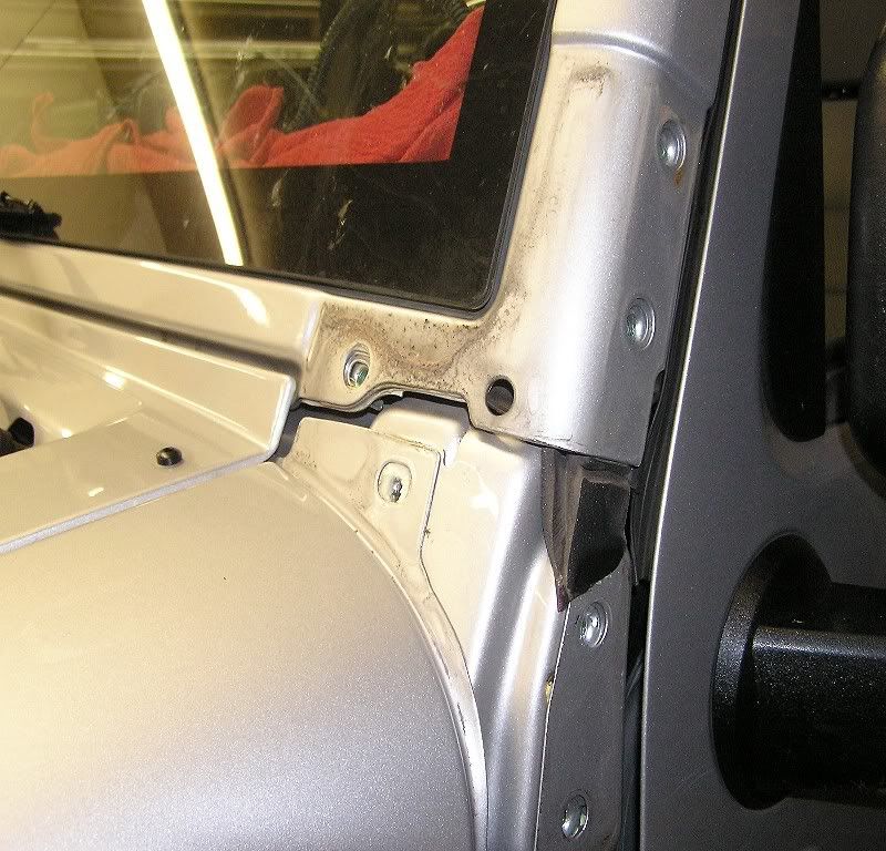

This bracket will need to be removed also. Just remove all the screws and lift off. Use #40 torx
Here it is removed.

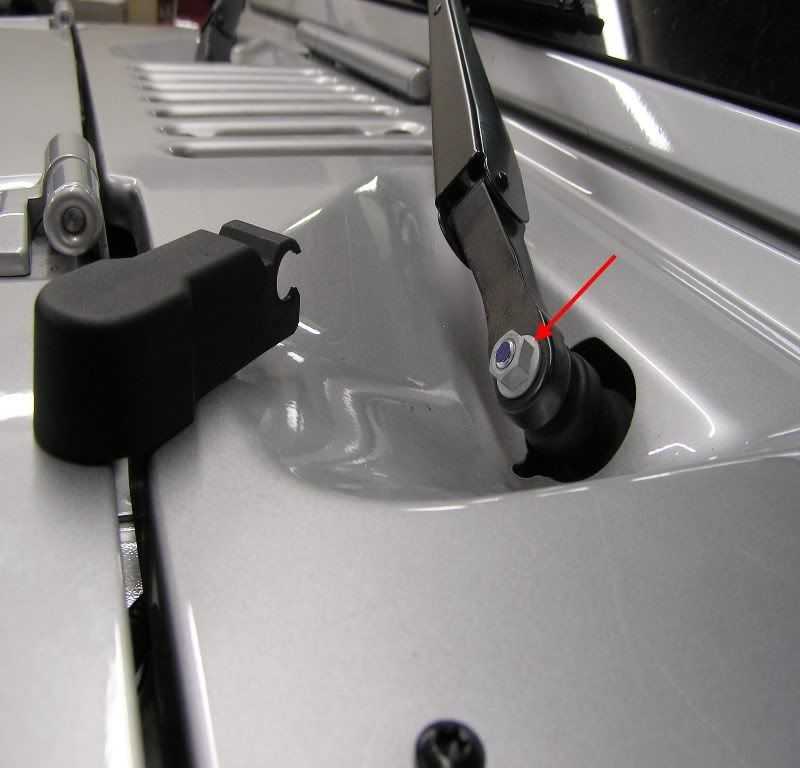

To remove the wiper arms youíll first need to remove this cover. Just grab it and pull off. Itís not hard at all.

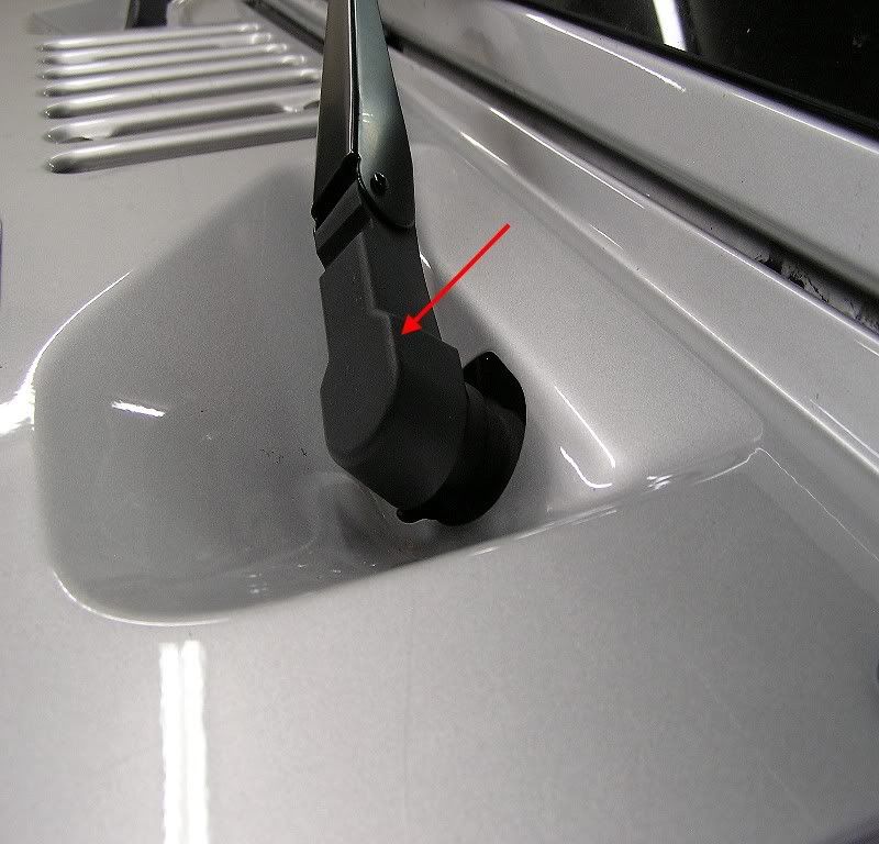

Remove this nut and pull the arm straight off. The arm was stuck on mine so be very careful when pulling or prying off. Remember, the sheet metal on our Jeeps is very thin. Once it starts to move it will slip of easily. 13mm

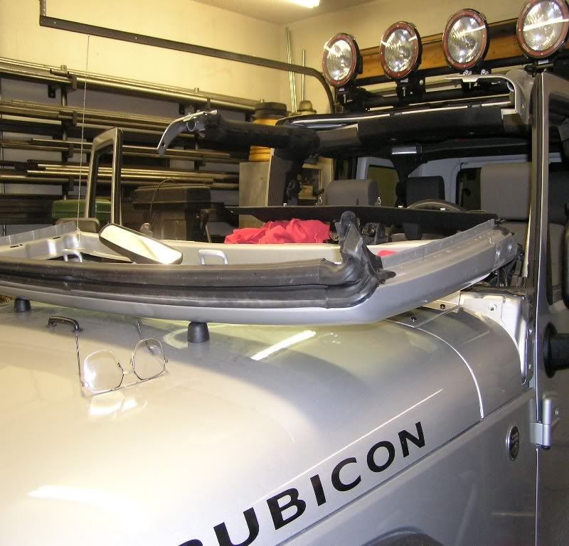

At this point the windshield is ready to go down, kinda. Your supposed to remove the entire roll bar to windshield tube brace but since my window was going back up as soon as I was done and the fact that the hard top would have to be lifted I choose not too. With that said youíll need to pry up a bit so the windshield frame will clear the visor nuts.

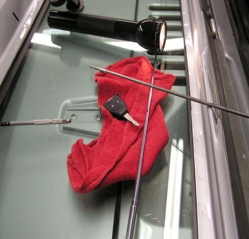

And there it is, my key.
