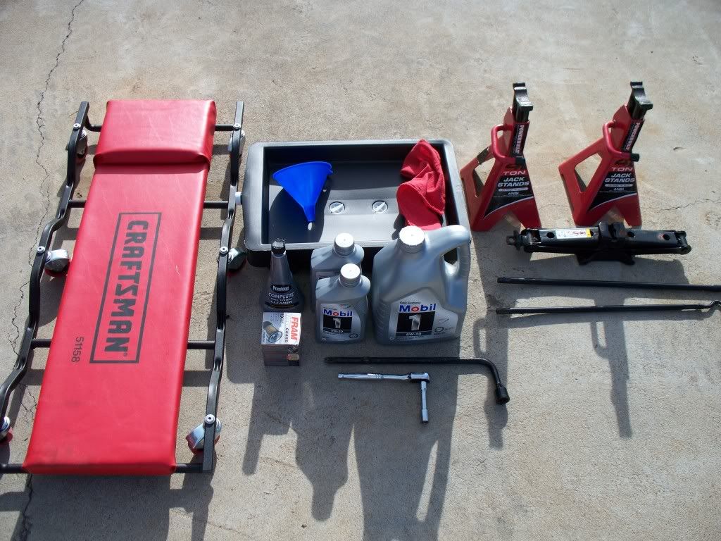

Things you will need:
-Creeper (optional)
-x2 Jackstands
-Scissor Jack (found in your storage compartment)
-Lug Wrench
-13mm Socket w/extension and ratchet
-Oil filter wrench
-7qt Mobil1 5w-20 Full Synthetic oil
-Fram ToughGuard TG3614 oil filter
-Oil pan
-Funnel
-Oil rag
-Prestone Complete Fuel System Cleaner (Optional)
-Chock block(s)
-x1 JK Wrangler

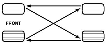

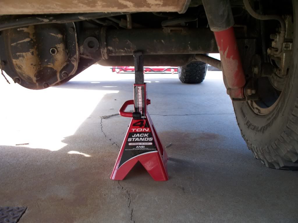

Tire Rotation: To prevent uneven wear because all of your tires do not wear the same.
Remember to put the Jeep in PARK and chock the front wheels before jacking it up. The lift points are fairly easy to find, pretty much anywhere on the axles does the trick, however the closer you can put it to the wheel the more stable it will be.
Removing the lugs from the wheel will take some force, applying pressure with your foot does the trick for stubborn lugs. Remember to inspect your brake lines for anything fishy after you remove each wheel.
This is the tire rotation diagram:

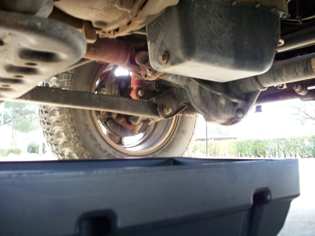

Once you have completed rotating the tires move your oil drip pan under the oil drain plug on your Jeep.

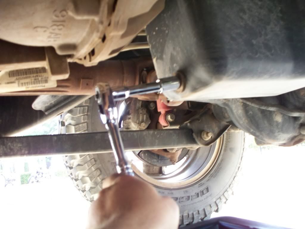

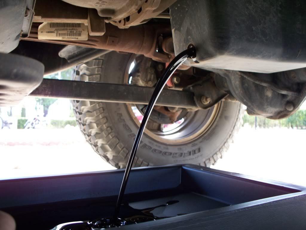

Now take your 13mm socket and begin to loosen the drain plug, make sure the Jeep has been off for a while before doing this otherwise your hand will get scalded by oil.
Remove the plug by hand once it is loose so it doesn't shoot off and get dirty or lost, and let the oil flow.
After about 10 minutes the oil should have slowed to a slow drip, go ahead and reinstall the drain plug. After you have done that, scoot the oil pan under the oil filter area.

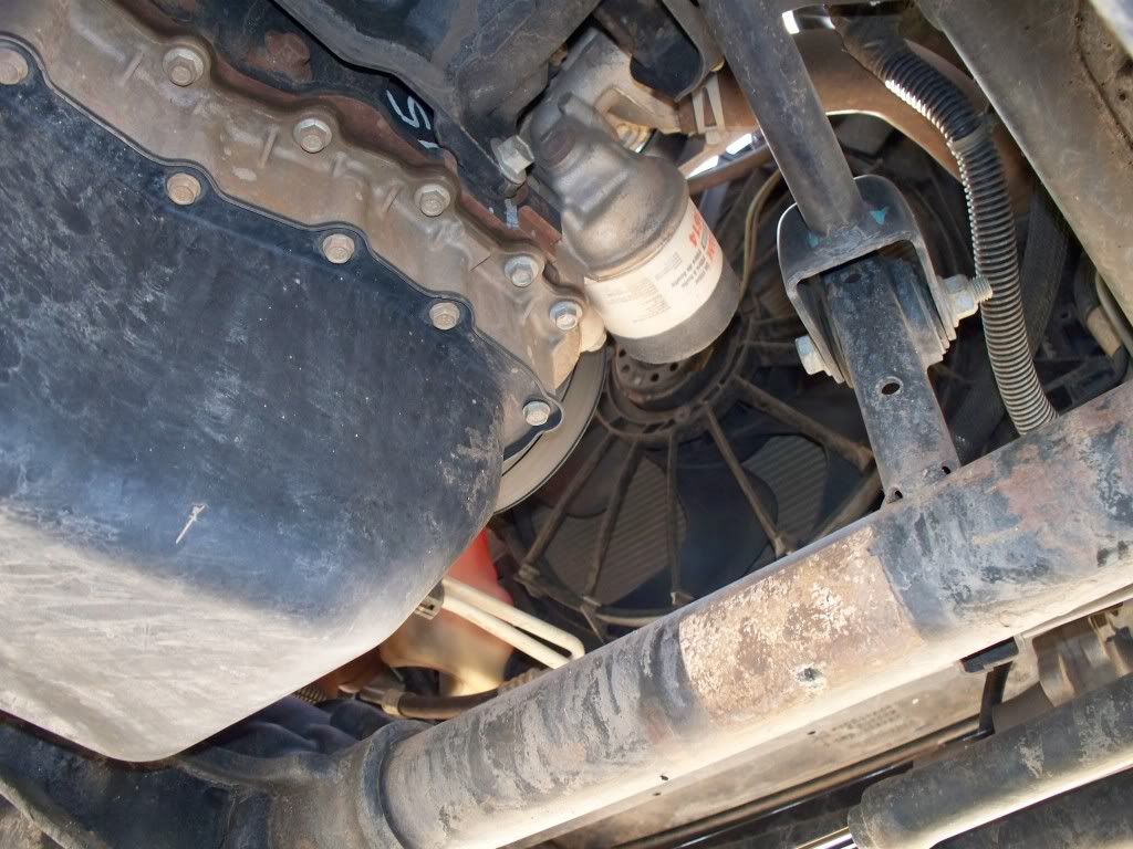

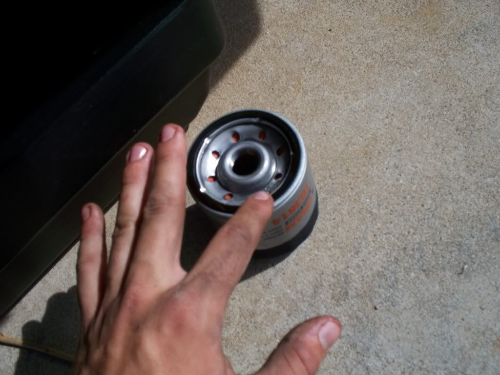

Now get up, grab your oil filter wrench, and remove the filter (working from the top gives you more leverage and avoids the chance of you getting splashed with oil).
Once you have removed the filter, let the oil in it drain into the pan and put it in the new filter box.
Now take your finger, get it nice and wet with the used oil in your pan, and run it along the rubber seal on your new filter. This will prevent damage to the filter's seal when installation occurs.
Reinstall the new filter by hand, DO NOT use the oil filter wrench- anymore than hand tight can damage the filter seal! You do NOT want this to happen, trust me, it creates a giant pool of oil when you go to start the Jeep.

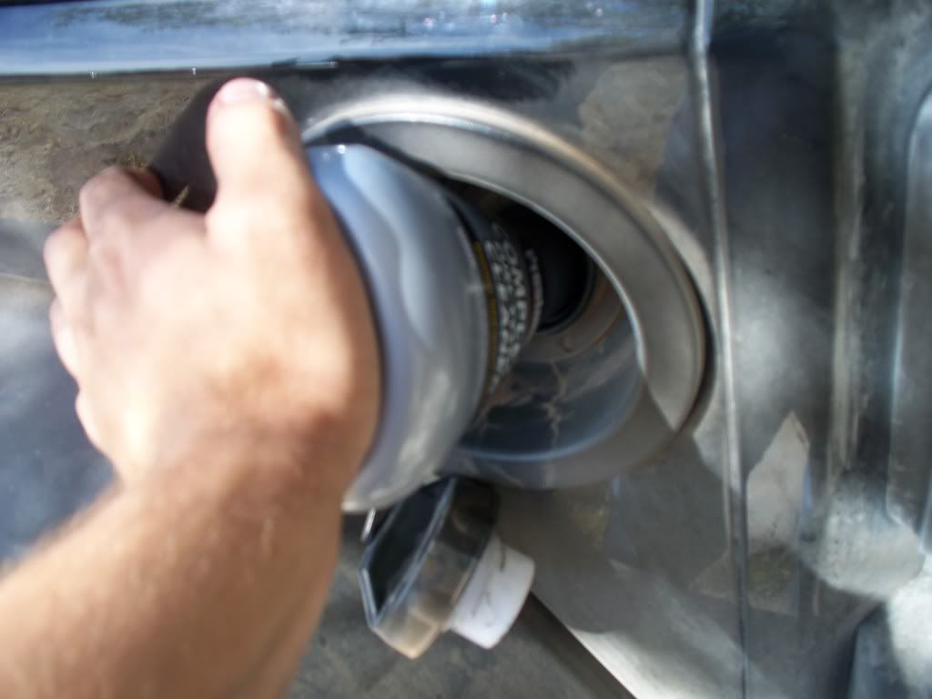

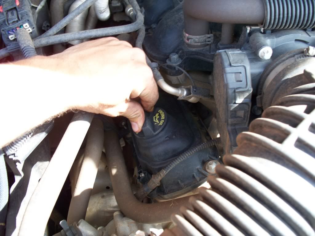

Now open the oil cap, insert your funnel and begin to pour (6 quarts to start).

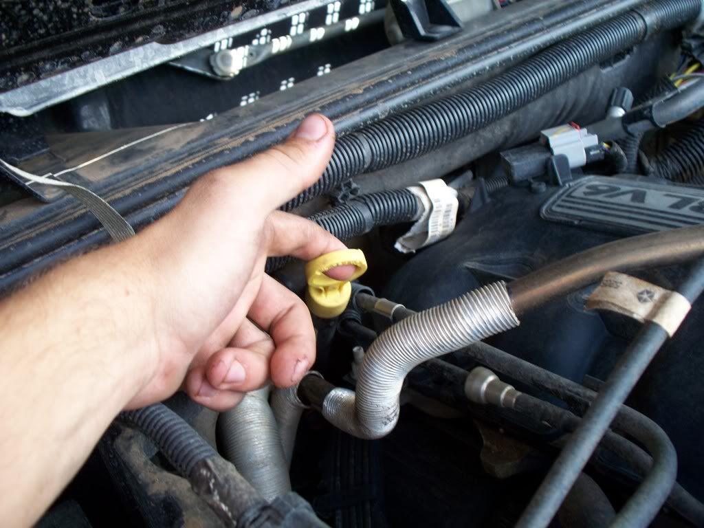

While you let the oil settle, check your transmission fluid.
Also, if you feel so inclined while waiting, add your fuel system cleaner at this time. Remember, you must have a full tank in order to add the cleaner, if you don't- after the service is complete let your 'test drive' be to a gas station to fill up and add the cleaner.

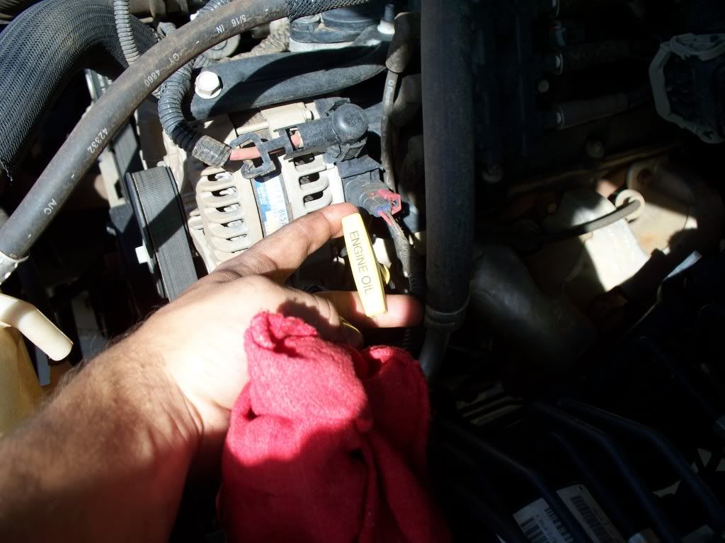

OK, at this time check the oil level with the dipstick, check it at least twice.
If everything checks out reinstall the oil cap, start the Jeep and let it run for a few minutes, this lets the new oil cycle into the motor. After a few minutes, shut it off and check the oil a few more times, I had to add another 500mL (1/2 quart)- and you may need to as well- this is where the 7th quart comes in handy.
