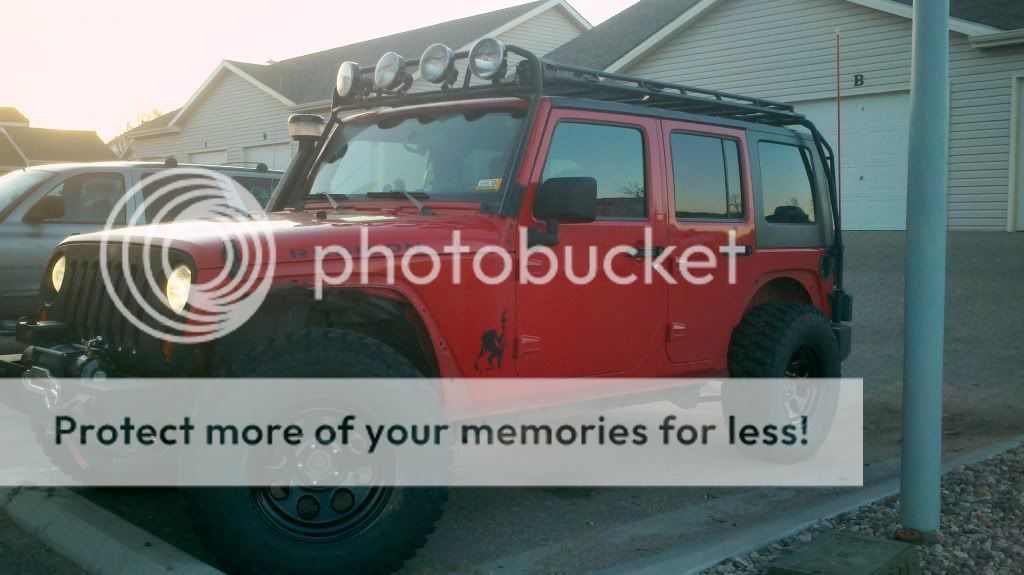

I'm set up with a Teraflex 4" lift with sway bar disconnects with 35x12.50x17 on 17x9 Moto Metal 909 Skulls and 1.5" Spidertrax wheel spacers. Everything works great.
