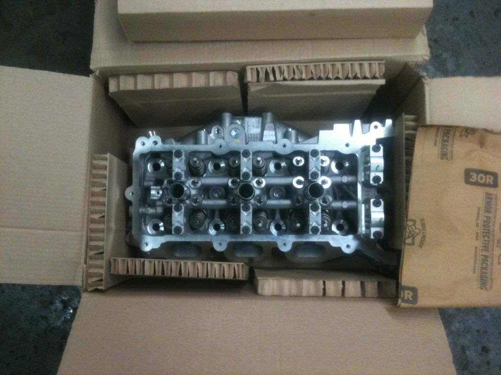

im doing one today actually.
ripped apart
fancy new head
old head. can you tell which cylinder? haha

What specifically is wrong with the old head? And did they finally stop putting those in the new builds? I have a 2013(build date Nov)

from what ive heard Chrysler wont actually release whats wrong with it. (I have my theories) If they do that then they make a TSB, if they make a TSB then it turns into a **** show.

The issue has to do with two things. 1. Hardness of valve seats. 2. Water boiling in a "trapped" spot. Correction went into production in March 2012. If you made it through this summer most likely you will never have an issue.

That's my theory but nothing is confirmed. But I've seen evidence for other things too.
Ehhhhhh if you made it past this summer it just that it's due to luck. We do about 2 a week and know dealers who do far more then that. We can stall you by doing the reflash that's usally when we order the head and whatknot because you will be back in with a CEL in a week.
