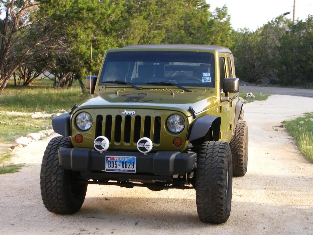

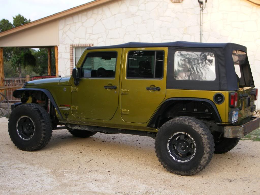

Just tape em off and cut em( cut mine with sabre saw).I cut mine while still on Jeep. The rear I took the inner liner out.
On the front I just trimmed to edge of body to keep some debris off engine.Also trimmed front support to give a little strength to fender .And someplace to mount LED
marker/turn signal.
And your left over parts in the trash
Just take your time and stand back ,walk around look at it from all angles.BEFORE ANY CUTS!!!!

I aggree just use tape measure them off to make sure there even the sky's the limit on styles. Heres mine, I copied the cut from a guy online, lots of clearance and I think they look mean also I think you mentioned a stubby bumper. I just hacked it off with a reciprocating saw at an angle and it was really easy! Good luck. Also I painted the rivits with black spray paint other wise it looked like rhinestones

This looks awesome. It looks like you have a smooth maybe 1/4" edge around where you cut? Is that something you did by sanding, or some other treatment?

something similar to this I would assume.
http://www.brandsport.com/ptrm-1150-11-05.html
2011 JK Rubicon 2 door 6-speed manual, 3.5" Rock Krawler Suspension lift, 1.25" Daystar body lift, 40x13.50R17 Nitto Mud Grapplers
DrHolliday is offline
post #13 of 31 Old 01-01-2012, 08:09 PM
Quentin_T
Quentin_T's Avatar
Location: Manchester
Posts: 146
Yep, 25' of black door trim from pep boys for me.
