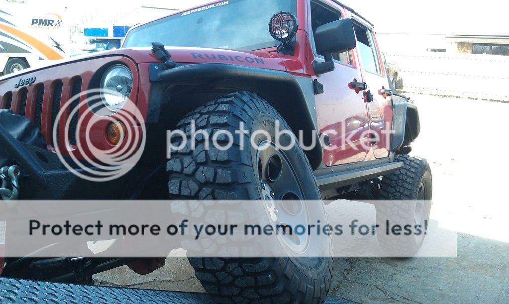

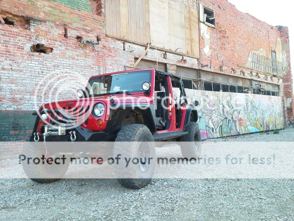

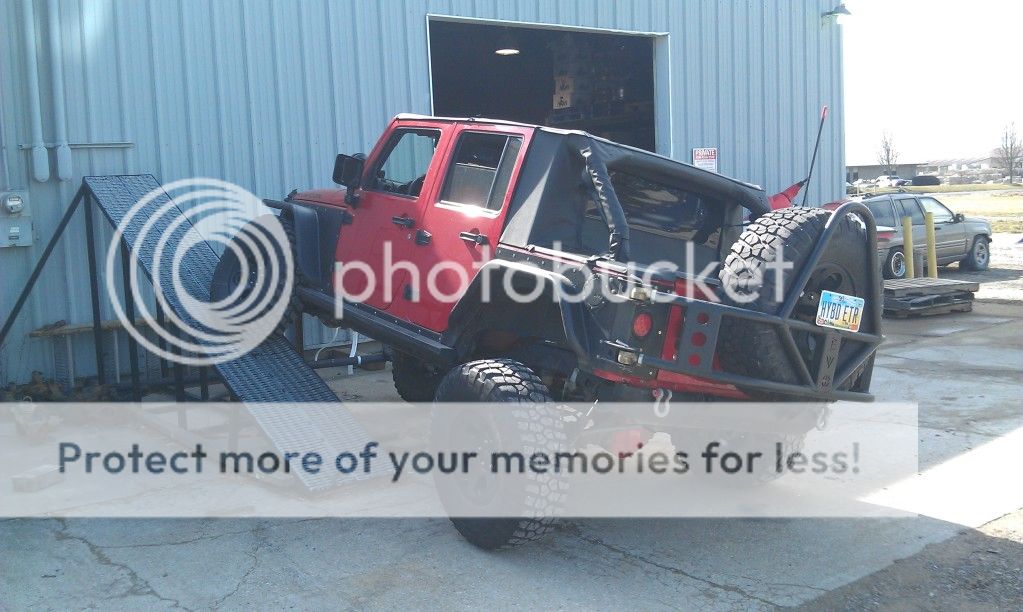

Here's a fee pics from awhile back....its magic I guess
37x12.50 km2s on Savegres, 3" tera and next gen Currie tie rod
