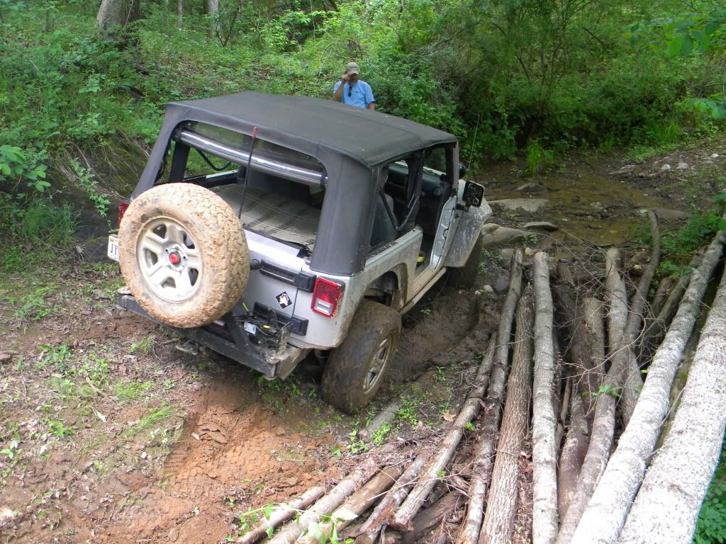

I spliced wiring onto the old leads, and have it coiled up inside the tailgate for the one day a year that I need it. NAPA sells lights that will work for ~$5.00, and I ran the wiring up through the center of the carrier itself. (Drilled one hole).
Here's an old pic:

From my own experience, the whole plastic POS lens cover broke into pieces with your idea in mind = no OEM light to work with
and VA doesn't require fenders, but a tree knocked it off the day of that photo
