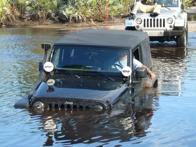

mrsig, did you check your differentials after the water crossing in the second pic? Water higher than 18 inches submerges the diff breathing tube.

post #24 of 30 Old 06-15-2010, 10:22 PM
MilitaryJK4455
2010 JK Wrangler
Location: Ft. Detrick MD
Posts: 2,624
I believe you but I dont understad that... Jeep states that the wrangler can do water fording up to 30"...

Posts: 2,189
I think my owners manual said 24". I'll have to double check. At any rate, I recall seeing my diff breather tubes running up near the top of the radiator and the rear going up the fuel filler tube? Both of those are well above 24-30".
All ways but I don't need to worry all 4 of my breathers are raised up.
Pg. 292 of our owners manual:
Standing Water
Avoid driving in standing water deeper than 20 inches,
and reduce speed appropriately to minimize wave effects.
Maximum speed in 20 inches of water is less than 5
mph (8 km/h).
