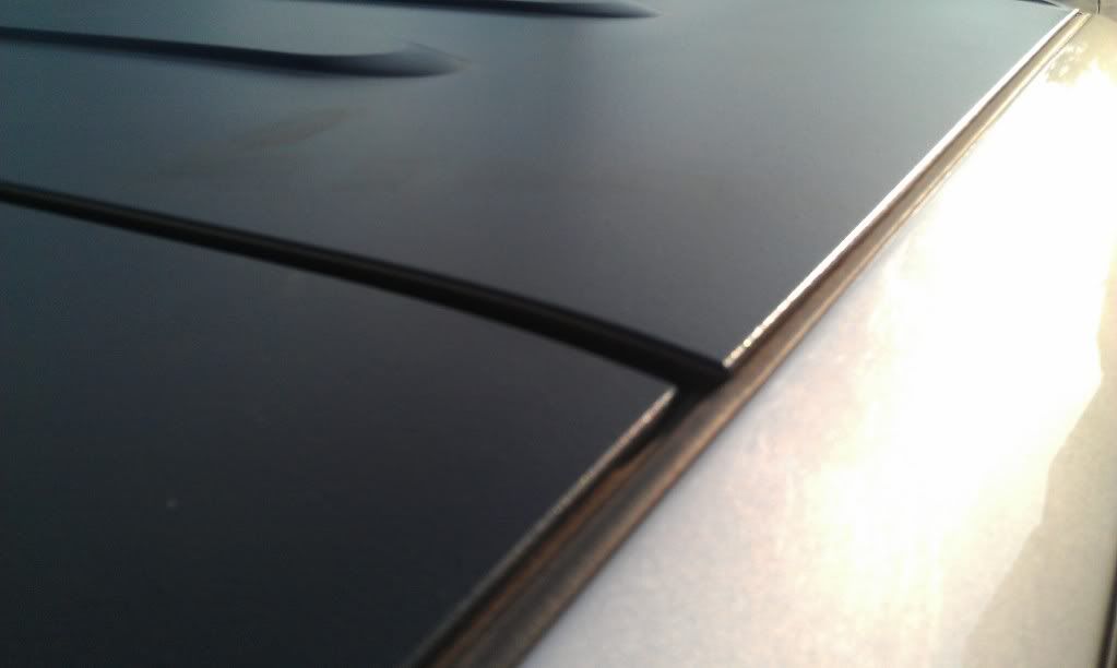

Ok, here is a front and rear of where the two freedom panels bump against the rear roof and the windshield
(see next posts, I guess, lol)

Something isn't right!
Have you ever lowered the windshield?
Did you buy it new or used?
Jim

This might seem stupid but have you checked and made sure the backs on right

Just because it's new doesn't mean they put it together right to start with. Pull the rear section and make sure it's seated right then check the front
