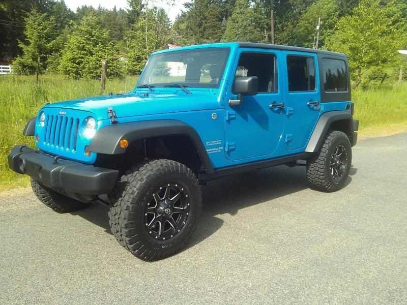

So a buddy just dropped off a brand new, zero mile set of Rubi shocks and coils (18/58) take-offs.
I already have 1.5" pucks w/o the factory isolator to level things up, and 17/58 coils. It sits nice and level, but I'd like another inch or two of clearance, especially out back. (But I'll do the same front/back to keep it level)
Any noticeable lift difference from the 17's to the 18's? Would it be worth installing them and the rubber factory isolater to get a bit (1") more lift? (Then raise the back 1" to match) Are the Rubi shocks worth installing, and if so, do I have to add extensions to run them up front?
Or should I skip all that and add 2" BDS coils/shocks and be done w/it?

well, thanks for all the input and comments
I ended up not using the Rubi springs/shocks, but rather, bought a 2" BDS coil lift kit instead. I wanted a full 2" of lift in the rear (my visual preference- not clearance related) but wanted to keep the front level.
quick recap
stock
front 1.5 leveling kit only (and new shoes)
2" BDS coils AND front 1.5" leveling kit (poly spacers)
mission accomplished!

We did end up putting them back in, under the poly pucks, and on top of the coil. They did seem to smooth the ride out a bit
