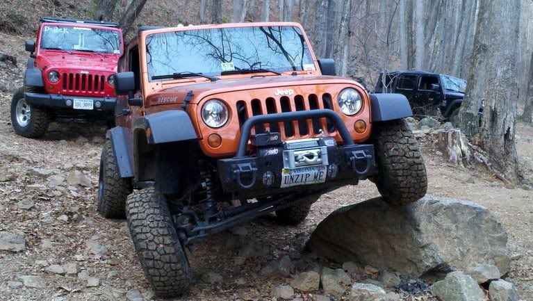

You'll be fine, I run a 10.50" tire on a 10" wide wheel without any issues. I have put 50k miles on this setup on the JK and I also have this setup on a TJ Rubi that I do maintenance on.
As far as the backspacing and touching fenders- bumpstops will solve it. I have 4dr coils and wheels with essentially 2" of backspacing and they touch the fenders with just 31's.

Yup i see that back tire is ready to start eating some fender. Extended bumpstops seem like they take away valuable wheel up travel.
So based off your 2" backspace (making your tire stick out a good 2") a 12.50 tire if it is only 11.50 wide with 4.5bs wheel should move the tire in 2.5 more inches and will be pretty close to edge for edge on tire and fender. Am i reading you right?

^^ to explain what is going on there- the bumpstop tells your suspension where it will stop compressing. So no matter if you have a 15" lift coil or a 2" shorter coil, the bumpstop will still stop your axle in the same spot everytime.
You could (and some people even recommend) do just larger bumpstops and go straight to 35's. You wouldn't contact your fenders and you would be on 35's, but- you would have extremely limited up travel. I had 35's on my jeep without any lift but it would have rubbed the fenders like crazy.
edit: 12.50's on stock rubi wheels and with spidertrax spacers do sit pretty flush with the fender, maybe stick out just a little. That is 35's and no lift.
