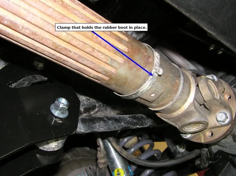

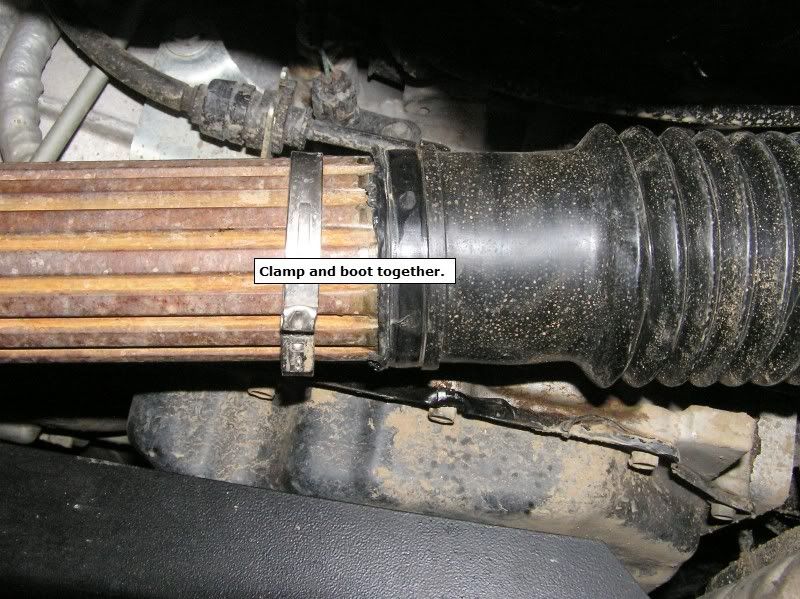

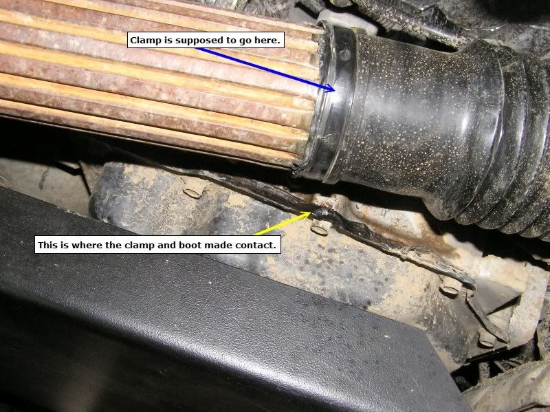

While under my Jeep installing AEVís LFCA brackets I noticed that the clamp that holds the rubber boot on the front drive shaft was way up at the front of the shaft. It had been pulled off. It was still intact and not damaged at all. At first I couldnít figure out how in the heck that could have happened. Finally I saw it. The shaft will move way over towards the transmission oil pan and make contact during extreme articulation. The pan lip was bent up where the clamp made contact. Never thought that could happen. Anyhow, Iím looking at getting an after-market drive shaft for sure now. The boot is fine so I think Iíll use some bailing wire to fix it till it gets replaced.
This is where i found it resting.

I think there are two places where the boot can be affected by a lift: the boot clip hitting the automatic transmission oil pan and the boot hitting the skid.
When you install your lift, the front axle shifts away from the transmission pan. If your lift doesnít have any correction for the axle shift, then you may not hit your automatic transmission pan. I installed a front adjustable trac bar which brought the axle back, though even with shifting it back it took me over 5,000 miles to flex it just right and have the clip in the right place to tag my clip:
I measured and it just barely hit, so I made a lower profile clip which has held up for over 10,000 miles.
The other problem is with the skid. If your lift/shocks allows extra droop then your driveshaft can droop into the skid and cut the boot. A friend of mine installed the exact same lift I have, except he got new shocks that allow more extension than my setup and so he could (and did) droop his driveshaft onto his skid and cut his boot. He also has an automatic but hasnít adjusted his axle, and hasnít hit his clip (like I have).
