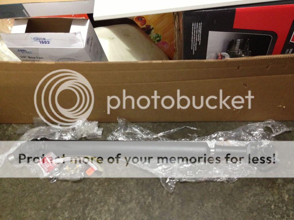

post #26 of 41 Old 08-15-2013, 08:58 PM Thread Starter
brianjw
Location: Hillsboro
Posts: 1,366
Well I finally got back home and had another woody waiting for me. This one goes in the rear. Ahem.
