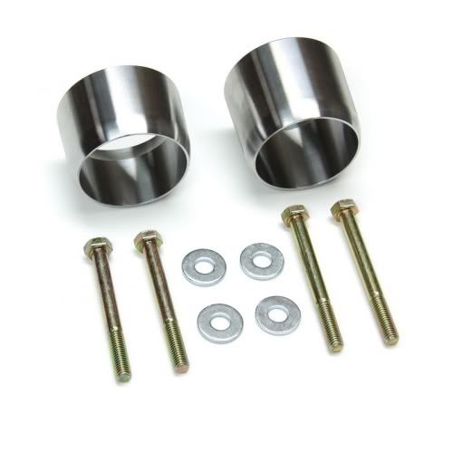

have you seen the teraflex exhaust spacer kit

Yes, along with a dozen threads on how the bolts don't fit, how they loosen up and are total crap until they rust in place...

bolt ons are not crap, the reason they don't work is because people bolt them on too tight and they bend making a break in the seal. or people don't put them on straight. just put these on my teachers jeep and no troubles 2 weeks in. have someone hold them in place till you get the bolts tight enough. and if you really don't want a leak just weld them in place

even if you put a skid when you put more than 3 inch of lift the driveshaft interfere with the exhaust that why teraflex develop this kit to get back the exhaust far enough to put a 5-6 inch lift without interference
