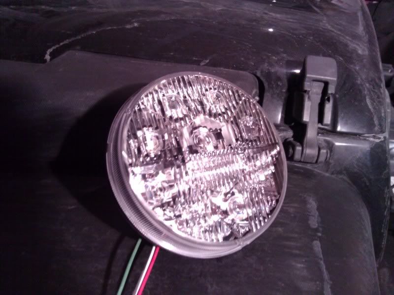

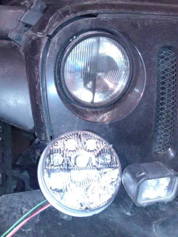

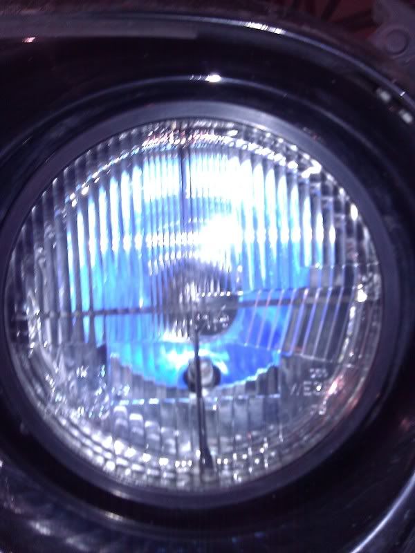

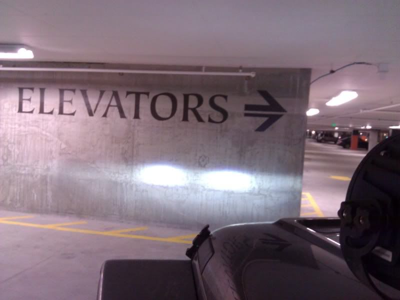

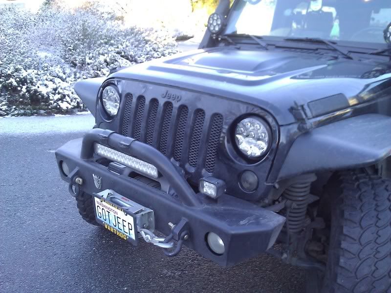

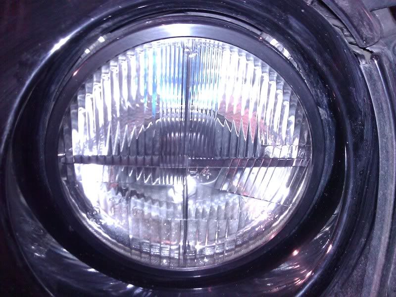

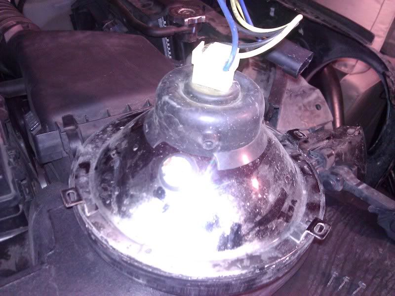

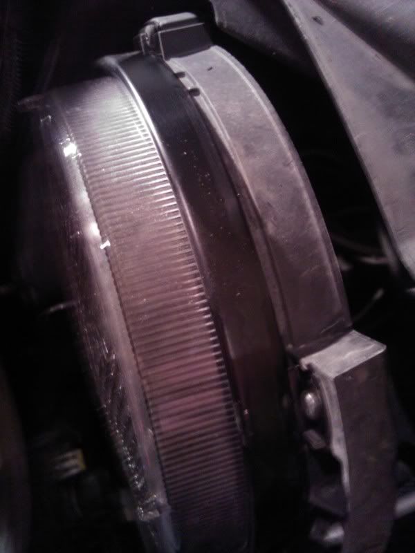

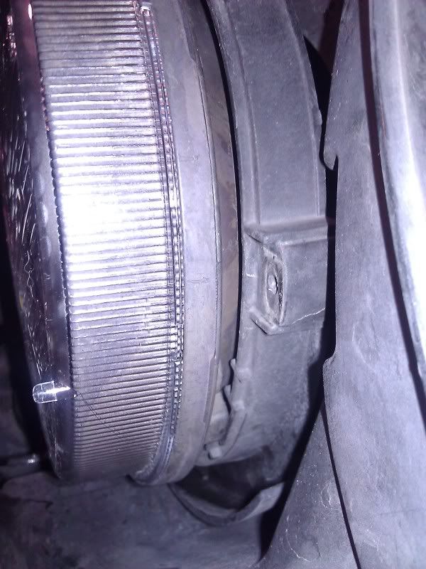

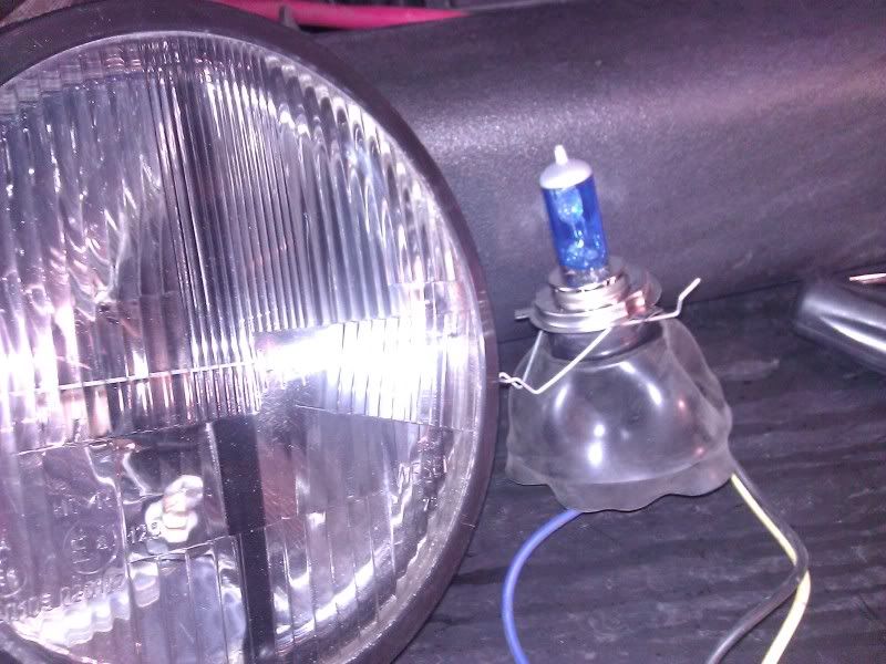

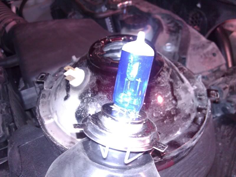

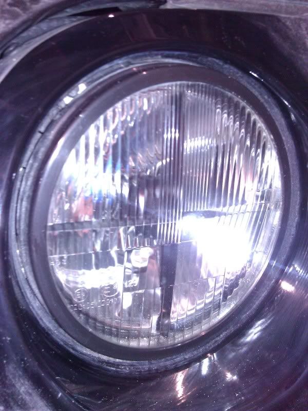

Some pics, and my final thoughts...
The Delta light housing and with the extra H13-H4 pigtail
Side by side
Delta light close-ups
Uninstalling the Deltas

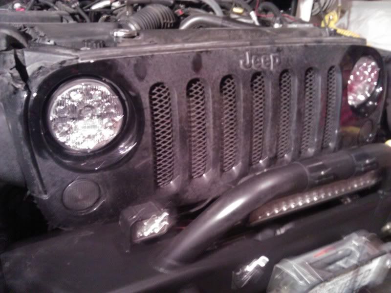

Installing the Truck Lite. On the passenger side, it did ont fit the tabs 100%, and I had to wedge it in. My Jeep’s issue, from a past impact, not the light. Good thing it was solidly built. On the driver’s side, it went in flush with no issues.
Installed
View of the hot spots
So my . If money were no object, I’d probably go with the Speaker lights. But it isn’t the slam dunk I thought it would be. And compared to the first generation lights from Truck Lites, these are miles better than they were, and significantly better than the Delta Quad Bar lights I suckered myself into. I am 100% pleased with the Truck Lites, and would enthusiastically recommend them to Jeep owners looking to upgrade their headlights. I’m going to run them for a bit longer, and if my opinion changes, I’ll update the tread. But I really am a lot more impressed with this product than I thought I would be.
If you want LED headlights and are on a budget, I would get the Truck Lights.
