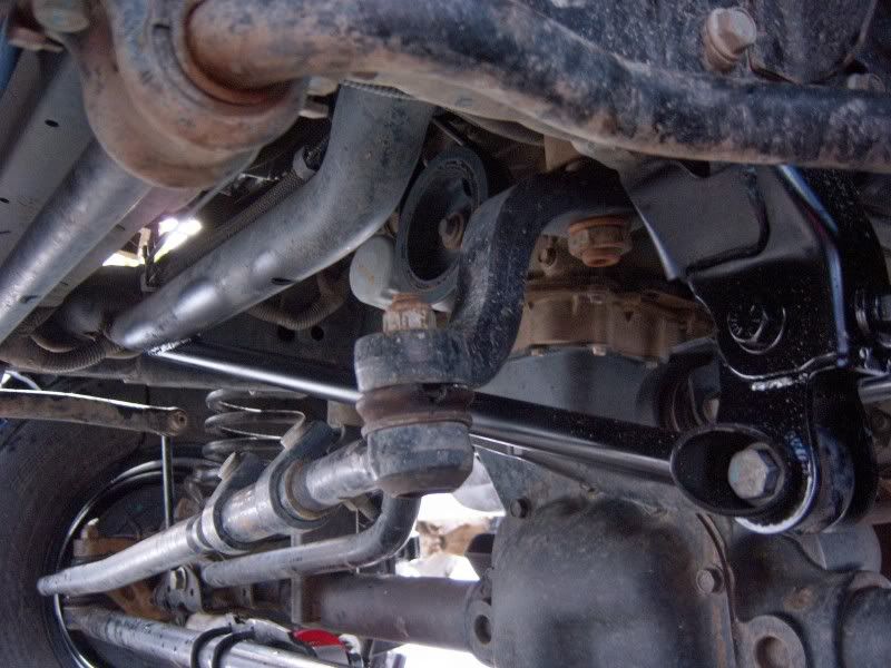

It finally drove me crazy enough to spend some time and fix it...
turns out the rough country track bar extension (upper) had come loose over time and was letting it shift back n forth. Decided to weld the bracket, and add some reinforcement. Shouldnt have any troubles now for a while..
Once i get more time/money/ambition im going to have a buddy fab up some new mounts and gussets for the lower mount (it was tight and holding up good still)
Nice to be able to drive like normal again lol

That front track bar can be the cause of many people's DW and can also be the easiest fix. Good job

Originally Posted by mrcrwly View Post
Glad you got it fixed
Questions for ya:
1. Are you running the bracket simply to reduce the angle of the TB with your 4" of lift or to save $$ on an adjustable TB??
2. Are you running a drop pitman arm?
3. Its hard to tell from that picture; how parallel are your trackbar and drag link to each other?
4. Also, I assume the bar that runs from the upper TB mount to the sway bar was your addition? Any issue with disconnecting the sway bar linkage (if you have quick discos)?
Questions for ya:
I don't think it goes to the sway bar....looks like it just goes to the cross-member behind the swaybar.
