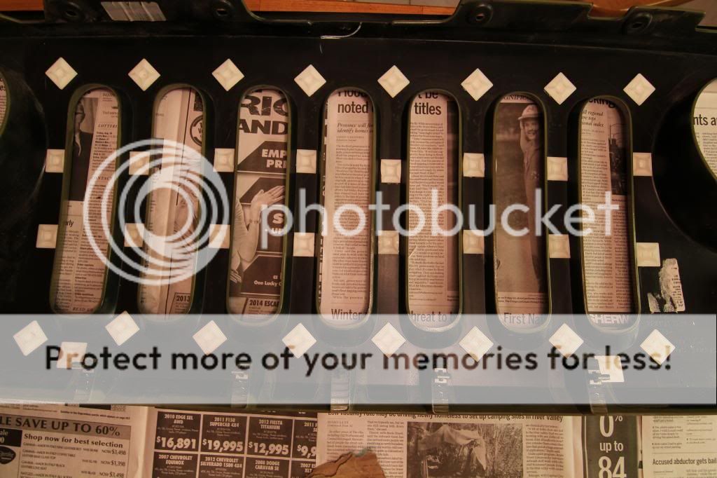

Alrighty everyone! The suspense is finally over!
Lots of fun little Zip tie mounts:

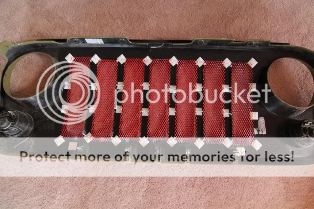

The look all secured to the grille (with 56 little ties!! ):
