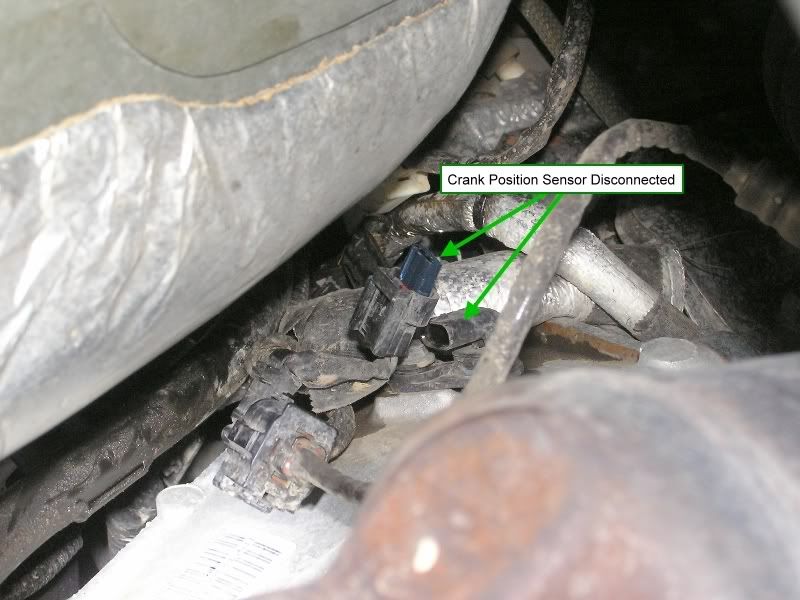

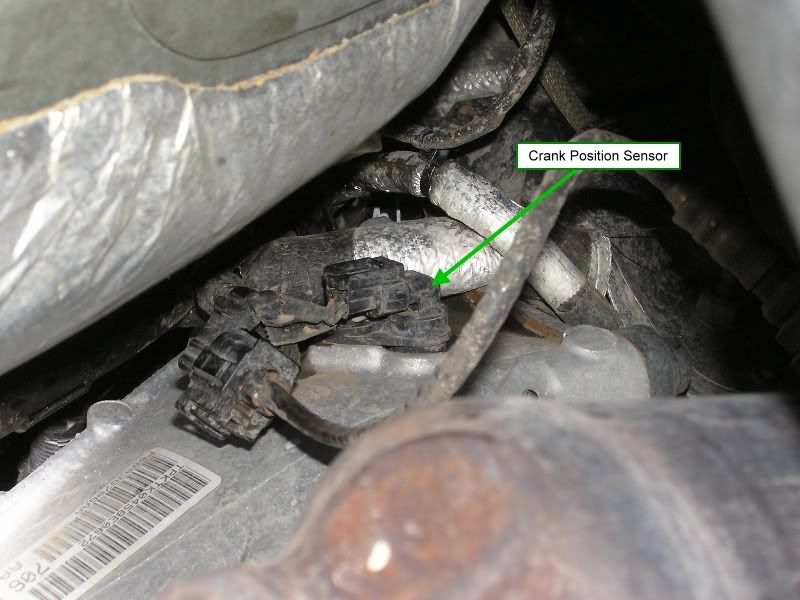

Update:
First off I want to thank everyone who responded to this thread. Every post was very helpful in that it helped eliminate certain causes relating to my Jeep. Some of the very same fixes that were mentioned have in fact fixed other Jeeps with the no-start issue in the past.
Hereís how I got my Jeep to start. What I did was to disconnect the Crank Position Sensor and then reconnect it. I canít take credit for the fix though. On another forum there is a 46-page thread on the no-start issue. On one of the posts it was mentioned that it had worked for at least one person so I gave it a try.
Now keep in mind that it doesnít work in all cases. Iím also hoping that it wasnít just a coincidence that it decided to start.
Here are a couple of pics incase someone else has the same problem and isnít quite sure where the sensor is located.
It is located on the right side towards the top of where the transmission and engine meet.
Just unplug and reconnect.
