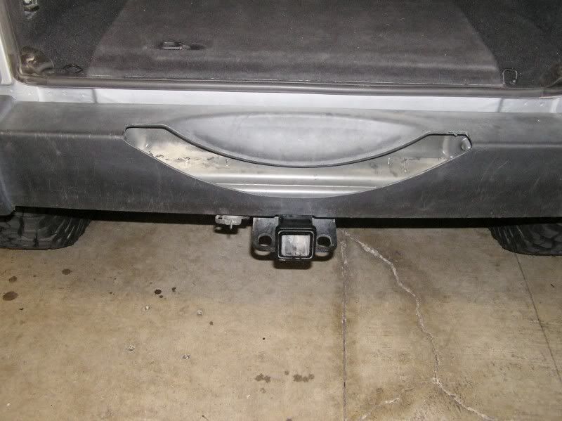

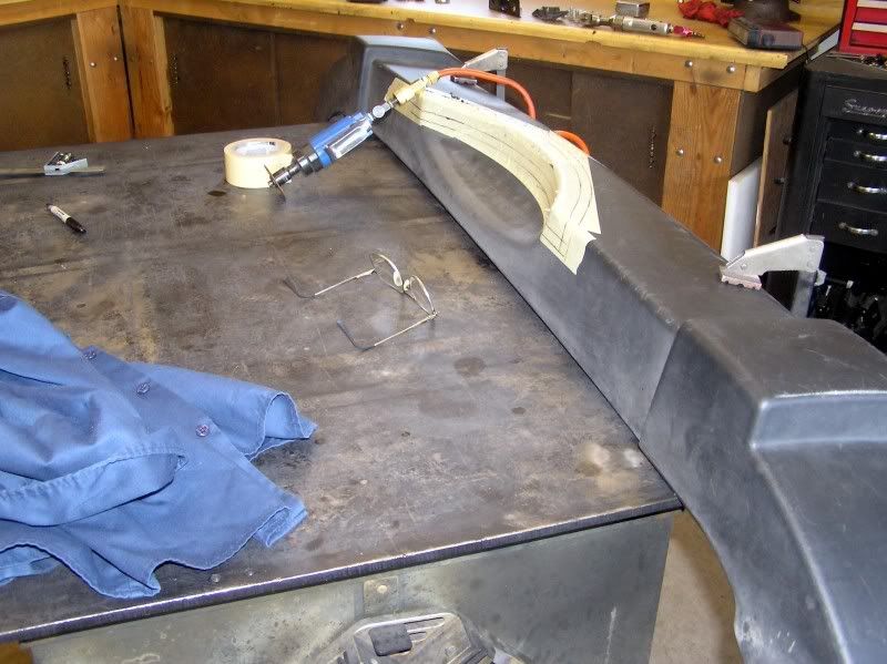

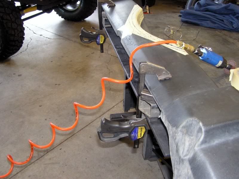

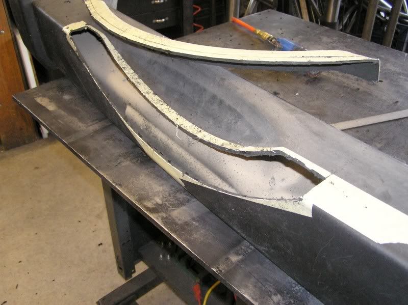

After installing my lift and getting larger tires (35ís), I needed to figure out how to mount my spare just like everyone else. Although I can fab-up my own bumper, itís taking a back seat for the time being. What I did to make the tire fit on the stock set-up was simple. I do not take the credit for this mod at all. I saw it on someoneís post and thought it was such great idea. I tried to find the post so I could give that person the credit but canít. When done, the tire just cleared the third brake light and the snubbers just touch the tire. So I bought the Daystar adj. snubbers but havenít installed them yet though. The pics show what I did.
First I marked where I wanted to cut and then clamped the bumper down so as not to move while cutting.
Tape removed and de-bured.
Ready for the new tire. Thats it.

How you going to keep water and stuff out of that big hole?

A hole saw on either side under the bumper will take care of that. Plus itís only temporary. The tire covers most of the gap and sits very close to the cutout. So itís not like trees are going to fall in.
