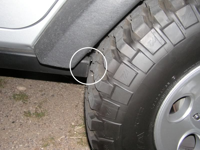

I was thinking that I would have to trim my Rock Sliders and pinch seam with the 35 BFG KM2ís installed so I tried it out on a little dirt mound in my yard. Glad I did, because if I would have gone wheeling there would have been some serious damage done to my rear tires. I know itís been done a thousand times before, but for those that arenít quite sure, here are a few pics of how itís done.
This is the small dirt mound i used.
Good thing i got out to see how close the tire was getting.

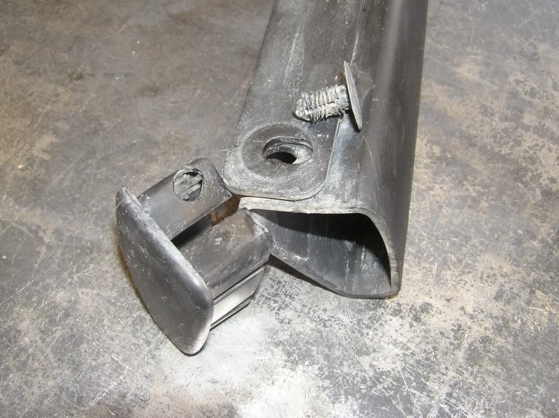

Thereís a plastic retainer plug that keeps the end cap from coming off. It will have to be removed to separate the cap from the Slider.
Although I used a plasma cutter, you can use a swazall, cut-off wheel or hack saw. I measured 1inch and made my cuts.
After the cut, clean it all up.

This is a pic of the Jeep in the same spot on the dirt mound as in the beginning. As you can see, there is now plenty of room.
Iíve read how some people pound over the pinch seam with a hammer, but I personally donít like the ďhacked jobĒ look. I didnít time it, but this mod really doesnít take long. I guess it would depend on the cutting method.

Would the amount you trimmed off leave enough room for 37" KM2s? Right now I have 35" MTZs and the pinch seam/rail was never and issue.
Thanks.

I am curious about that too. I currently have 35's on a 5" lift and havent had ANY issues with the rock slide or pinch seams. Currently have plenty of room for tire to get by, but if I was to goto 37's I would probably need to do this, but am curious if this alone will make enough room for those larger diameter tires?

I donít see why you guys would have plenty of room for your tires unless you have adjustable rear control arms and are able to re-center your axle. Even so, the rear of the tire might then become an issue. Maybe too youíre bump stops are really tall. Are you sure you flexed it out all the way? I have literally only a fraction on an inch clearance between my tire and fender as it is. Anyhow, I doubt very much that just an inch off the pinch seam would be enough to clear 37ís.
