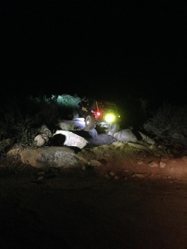

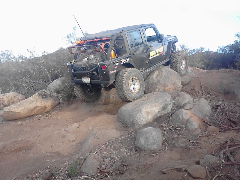

2010 Rubicon fully loaded (got a screaming deal on it or I'd have bought another "X")
Its main purpose is rocks, this is my 3rd JK in a little over a year first was mainly built that I finished off the last 2 were basically stock and I built. This one I have built bumpers, rack, fenders, armor, light mounts, and on, on, on...basically built it from ground up.
2010 Rubicon loaded

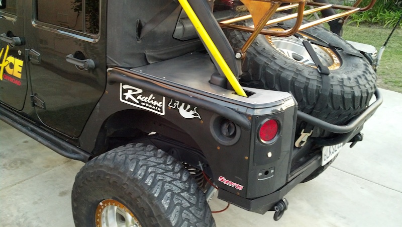

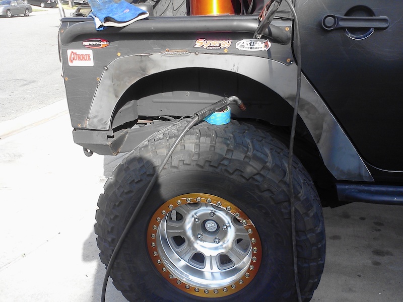

- fro t fenders
- rear corner armor
- rear tire mount
- rear wall

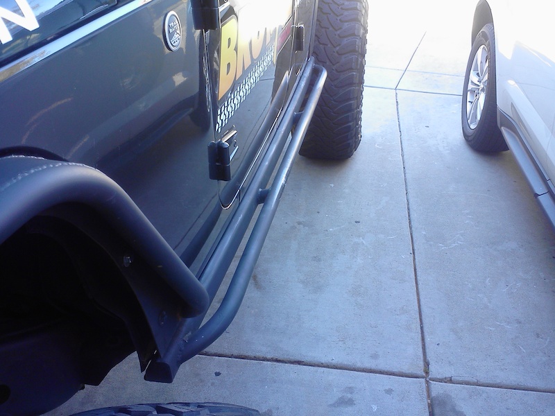

- slider tubes

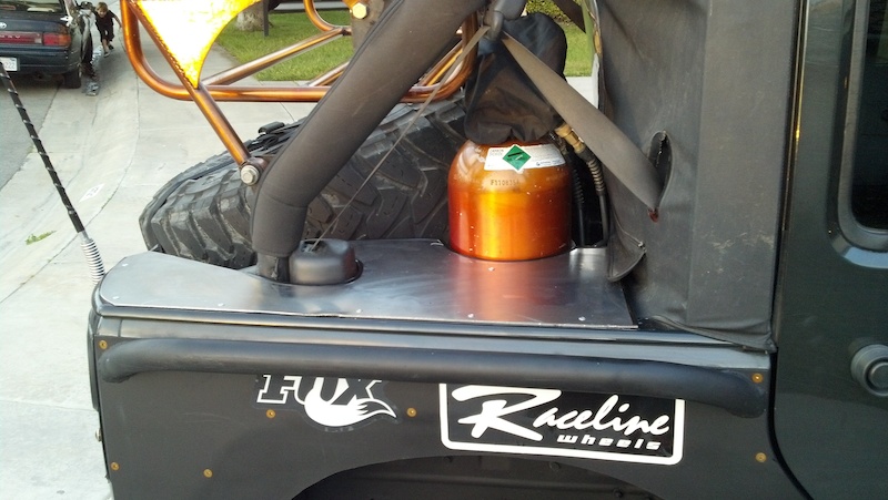

Made a 20lb Co2 set up

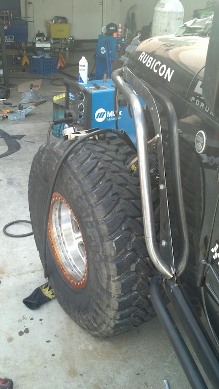

Rear tire carrier
Made a rear rack and aluminum rear wall

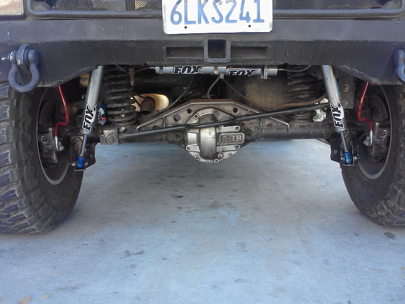

Made a rear tube to mount resevoirs

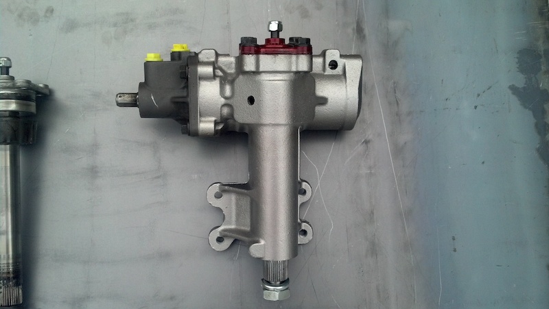

Tapped a box for hydro assist and stuck a PSC sector shaft in

Made front fenders
Made rear LCA raised brackets and shock mounts
Did some slider tubes
Relocated front shock mounts 2" out 1.5" up and rotated mou t 90*

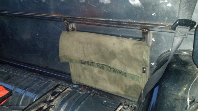

Started panels in rear

Added to the rear armlr
And all welded up ground and painted

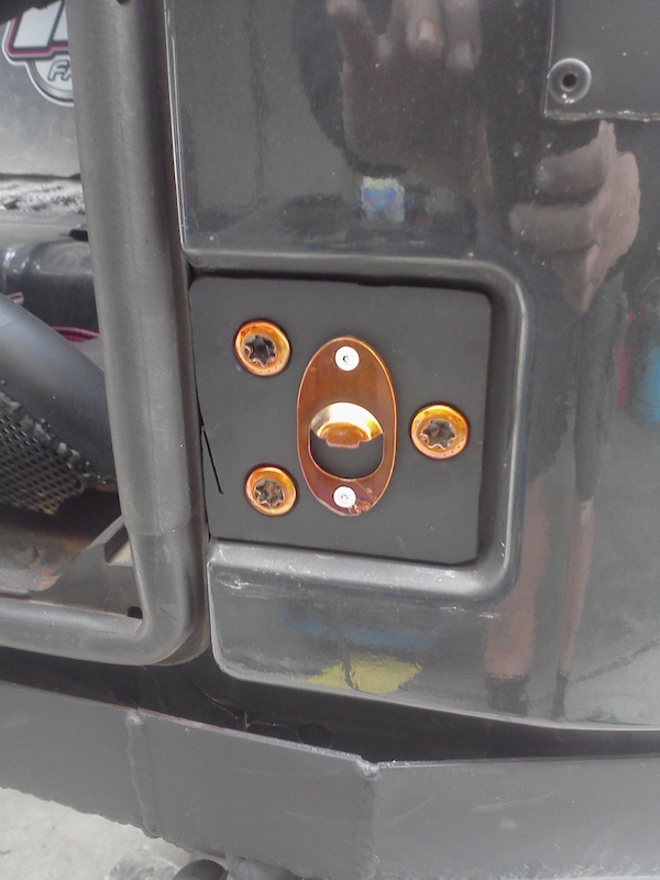

travis where did you get the bottle opener to bolt/weld on the rear? Im about to free that area up and I like the idea!
nevermind i found them. lol i was struggling to find the proper name, but wall mounted bottle opener did the trick!
