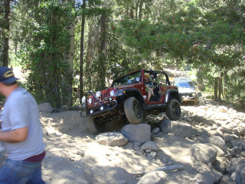

Here's a pic of them right before being used
