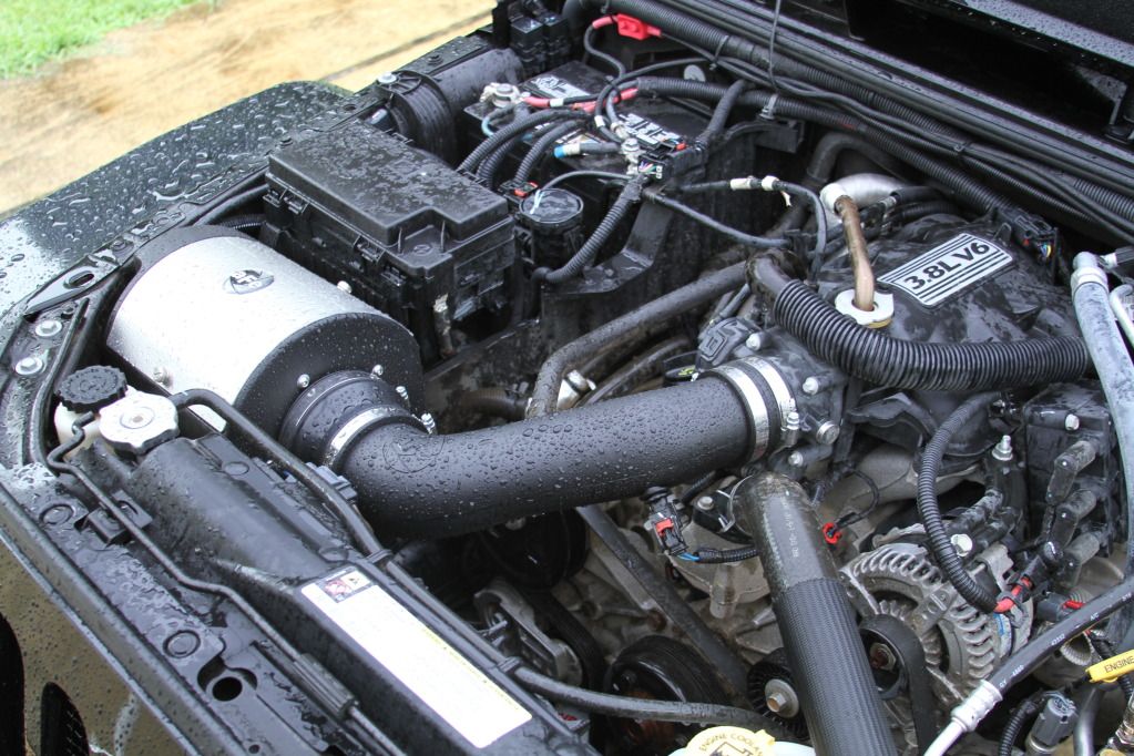

The install went flawless (besides my ECU and tune confusion noted in the previous post). Also to note, we installed RIPP SS long tube headers about a year ago.
First let me say a big thank you to Jeeprin and ArtiRubi for their respective write ups on their SC installs. The tips and tricks noted were invaluable:
http://www.jeepforum.com/forum/f96/r...ssion-1289123/
http://www.jeepforum.com/forum/f96/s...46/index4.html
The RIPP install documents are very detailed, accurate and have better “how-to” pictures than I can post so I won’t repeat anything contained there or in the referenced threads above.
But here are the requisite pictures:
The “Tactical Package” ordered came in blacked out condition (powder coated) from RIPP:
Before Install:
After Install:
Only one minor modification, had to elongate the top bracket holes for a proper fit and fabbed a bottom bracket to hold the intercooler a little more secure
Stealth mode … you can barely tell it’s there!
do or do not... there is no try - Yoda
