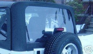

Hmm... Don't know whats going on with the foto's I attached in my first post. or why it wont let me upload one now. But, I found this one on the web. Is this the tab you're talking about? on the bottom left of the window? My OEM window has it. The Bestop window does not. Which one is which year?

No, the plastic retainer strips are above the driver and passenger doors on the '07-10 model soft tops. Starting with the '11s the drip rail no longer had the retainers.
I figure if you don't have the retainers then you have an '11 top. And that would explain the wider rear window.
Here is an old video. The retainers are removed at the 10 second mark.
