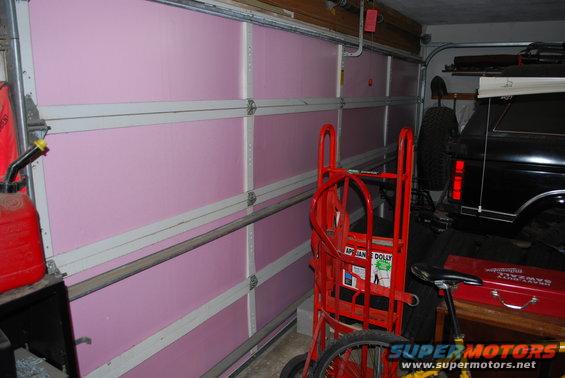

insulated garage door for summer months when i have a/c on in garage (rest of garage was already insulated)

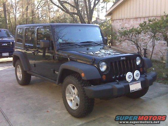

installed mod 16 today...
(fog lamps and remote relay)
hella 500ff
wiring for the remote relay and fog lights (fog light relay will not be used, but wires from it will)

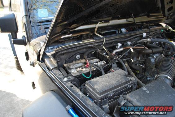

disconnect and remove battery (you'll need a 10mm socket to remove the battery holder)
measure for and drill your holes for the bolts from the lights. final size was a widened 3/8" but start out smaller.
greater love hath no man than this, that a man lay down his life for his friends -john 15:13
b_c is offline
post #118 of 577 Old 02-22-2009, 04:54 PM Thread Starter
b_c
Location: knee deep
Posts: 1,022
mount your lights and run your wires from the front to the back (you'll only need the y'd off black wire (connected to the black wires of each of the lights...the blue wires splice together and ground to metal part of bumper). follow the oem wrapped wires back to your passenger wheel well then up. you'll see a grommet that runs wires from inside/outside the jeep.
use a tool like this (1st pic; 6" piece of hanger, it was straight but bent in process) to push/pull the wires through...you'll need the light lead the pos lead and neg lead. (i forgot the neg lead but was able to tape it to the black wire and pull back through.)
mount the remote relay and connect wires (red is power-in, white is power-out, blacks are ground and can be spliced together, blue is the antenna and should just dangle like d's)
if you did everything correctly...the lights should turn on when you press the "on" button on the remote after you reconnect everything

what is that ugly jeep next to urs.. and i love the pink garage door...
FOR SALE!
R.E. Monotube Shocks - $200 NEW PRICE
[/color]
BiGEN is offline
post #120 of 577 Old 02-22-2009, 07:36 PM Thread Starter
b_c
Location: knee deep
Posts: 1,022
there's a black jeep next to mine
...dude seriously, that's the last time i send my wife to the hardware store.
