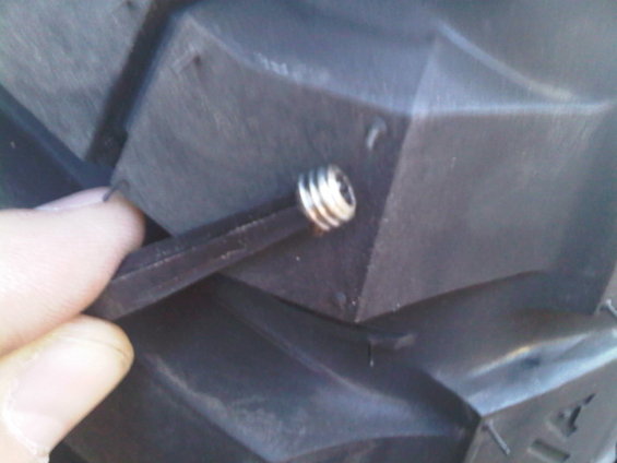

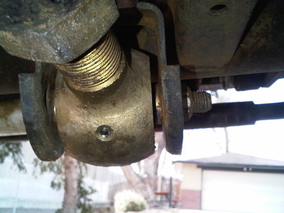

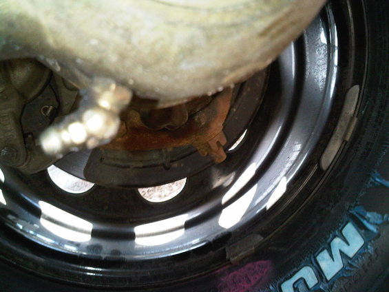

when i went to go get my tires on yesterday...the guy at the tire shop sheered off one of my zerk fittings that's on the front right lower control arm. so now the threaded part is still in the hole and there nothing to unscrew it with. the fitting has a hole through the middle so i went to the autoparts store and got an "easy out" tool.
i'll need to drill out the center a little, but i think the easy out will work.
here's some pics:
good zerk, bad design
broke zerk

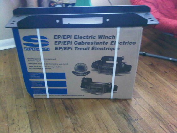

mod 40 - warn winch plate - bought this sucker off of ebay for at least half the cost. didn't come w/ any hardware, but fastenal and some grade 8's will be just fine. i don't see holes for the most outter most mounts on my bumper...BUT i see that on the quadratec website, there's bolts through them there holes. guess i'm gonna have to drill? anyone have any experience w/ the rancho bumper and a winch plate?
mod 41 - superwinch epi 9.0 winch - hopefully this will help at moab and in the snow next time i go.
(winch plate...ebay...$69.79 shipped ........ winch...amazon...$549 shipped)

well...thanks to a drill, a few bits, and a #1 easy out tool, i got the broke part of the zerk fitting out of the control arm...
...funny enough, i had some backups already (go figure, i knew it would be a problem at some point), but the ones i had were sae, and i needed metric. 6mm to be exact. bought a mixed pack, and ended up going w/ the stubby instead of the 45* one. i think it may save me some headaches in the future.
