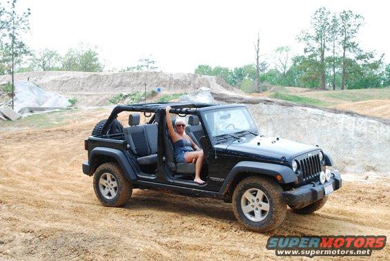

here's a couple of choice pics from this weekend's activities
...i disconnected the sway bar links for the first time this weekend. i will never wheel with them connected again!

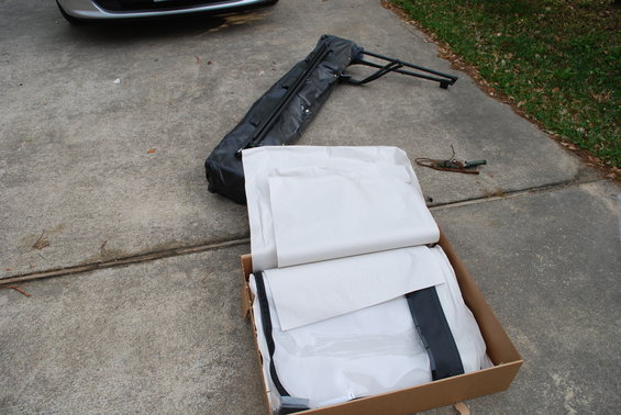

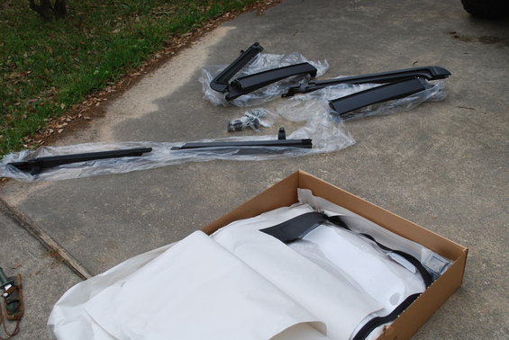

...after we got back from the creek yesterday, i asked my buddy to help me finally install mod 3, the soft top.
here's a couple of install pics:
parts included in my $300 deal of the century...
front/rear door surrounds and hardware (plastic molding that the top attaches to), top (mine came assembled, thank God), tail gate retainers, tail gate bar, roll bar brackets, and window inserts.

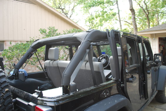

install all mounts
attach top to roll bar bracket (top being assemble already was a life saver)
massage into place...it'll take a while to stretch (took us about an hour @ ~76F)
zip in windows
...i like it

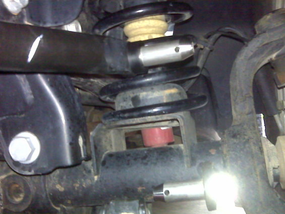

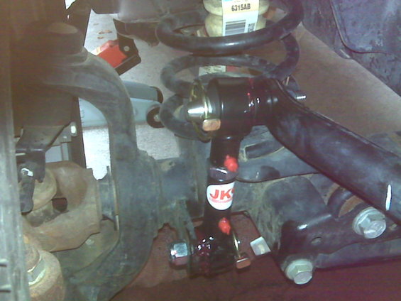

oh yeah...it's on AND off, now!
mod 18 - JKS "QUICKER" SWAY BAR DISCONNECTS P/N 2030- well, today, i went to go pickup the jks "quicker" disconnects from 4whlprts by my house. i ordered them yesterday, and they were there (w/ free shipping) by 12:20pm when i went by.
they took about an hour to install b/c i had "issues" with the upper bolts to the oem sway bar links. also, it took me about 5mins to figure out the verbiage of what way the inserts were supposed to be mounted.
it's all good, though. they're mounted
jks "quicker" sway bar disconnects p/n 2030 (4wheelparts...$145 w/ tax)

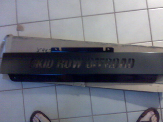

mod 20 - SKID ROW OFFROAD SKID PLATE - that goofy looking plastic skid plate is a pain in the *** to work around when under the jeep, and i freaking loathe those plastic screw retainer pins, any excuse to get rid of any plastic retainers is good news to me (especially outside the jeep)
i like the manufacturing and finish of the plate, BUT i have to admit: the look in the magazine is a bit deceptive. i thought it hung down a bit more to cover the steering components a bit more.
(quadratecDOTcom...$81.98 w/ shipping)

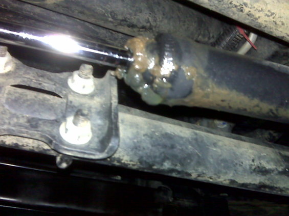

here's something to ponder:
yesterday, when i was under the jeep installing the skid plate, i happened to look up at the steering stabilizer and saw this
...it no looky too good
just called 4whlprts and they said they have a procomp replacement in stock for me to pickup if i want ~$38ish + tax. from what i see on the net that's a fairly good price (plus i'll get 5% off of that, anyway).
so what do ya'll think? replace? ...and if so, replace with procomp or with a different brand?

Dont get procomp...I'm not impressed with their shocks or SS's. If your still dead set on it. I'll give you mine, if you install a SS on my TJ along with my quick disco's. :-) It probably has 5k miles on it. Only a few months old.
