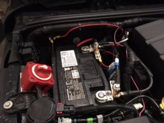

would take one heck of a fuse? i have a disconnect on mine on the hot lead at the battery. just never liked the idea in a wreck that cable goes to ground. or if say it stays on maybe like if a solenoid gets stuck etc.

yea that's why I was asking, the fuse required would be massive and $$$$. how does the disconnect work? do you just flip a level by the battery and your winch gets power?
You can use something like this.
They do sell remote solenoids you can trigger with a toggle switch from inside the Jeep. Make sure you get one rated to handle the amps your winch can draw.

A 600amp (250 break) solenoid works great as a disconnect.
