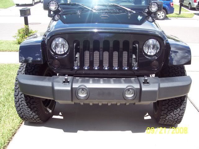

just do it yourself.
This is what you need
1 can of VHT nite shade spray paint
1 can of clearcoat

The VHT spray really is a better option. You can control exactly how dark you want it based on how many coats you apply, and if you do it right, and clear coat it, you'll look as good as any smoked lens you could buy.
GE2 has done it a few times I think, and they always look factory when done.

Originally Posted by Tmblack3 View Post
sorry to bring back the dead, but i plan on tinting my turn signals in my tj, how many coats would yall reccomend of the VHT and the clear coat?
thanks!
It all depends on how dark you want it. The spray goes on very thin, so light coats are the key. I think I did 3 coats of VHT and 2 coats of clearcoat on mine.
