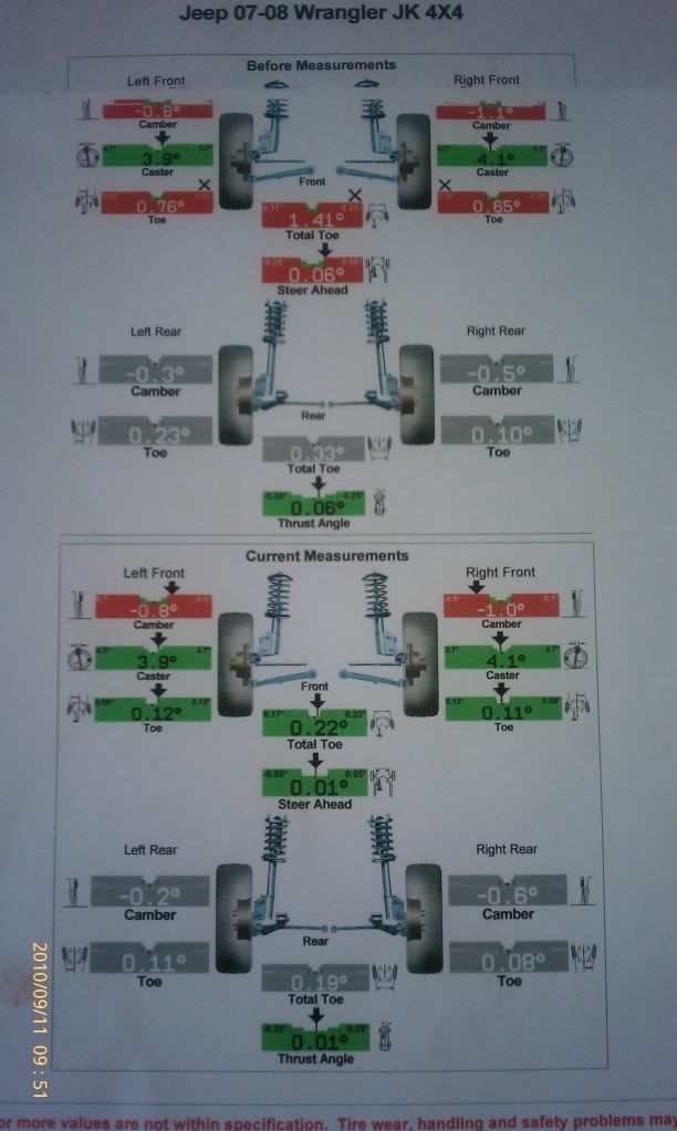

No its not pulling..... I had it alignedby a shop with a brand new laser alignment system...and they said my caster is off.... driver side -.08 and -1.0 passenger side....according to people above..... its either a bad ball joint or something is bent..
The max. camber difference between LH and RH can be .5 degrees. I was NOT going to worry about this..You camber is FIXED and with the tolerance stack up you easily can get this difference..
But I still don't understand whether you have a "driving related" issue or are you just reacting to what the alignment guy told you.. If it is the latter, suggest you have it rechecked on the same machine and you might have a different reading.. (Is called gage Repeatability and Reproducibility)

I apologize if I got peopoe mixed up.... its camber I am talking about and I thought it is suppose to closer to zero.....THUS why I am thinking that my 'c's maybe bent. However then there is the member that said above his brand new jk with 200miles on it is reading negative camper on both sides. I am not really sure what to think.... which why I originally posted

The spec is -.25 degrees and the Max LT/RT difference is specified as +/- .5 degrees..
I don't see SAI measurements.. Also the "steer ahead" is what the front will see in steer ahead condition.. Here you are fine.. I was not going to make an issue out of this.. but do like to see the SAI for LH and R front..

So help me understand these readings.
So my camber is ok although the reading says different?????

What he said is the spec is -0.25 and you have -1.0 and -0.8 which is more than spec - OTOH your difference is only 0.2 and the allowable is +- 0.5. You appear to have more negative camber than spec, but it is close to being OK regarding difference from one side to the other - others may chime in on what more negative camber may do or cause or if this is even acceptable.
