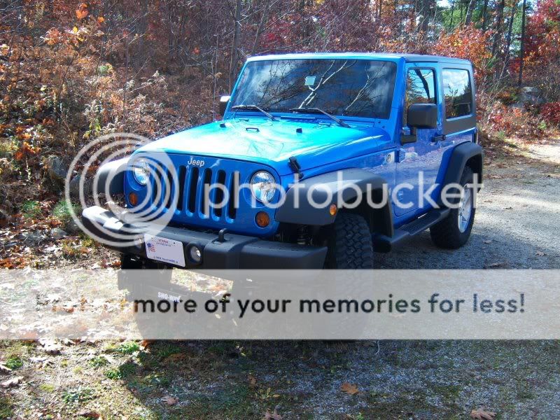

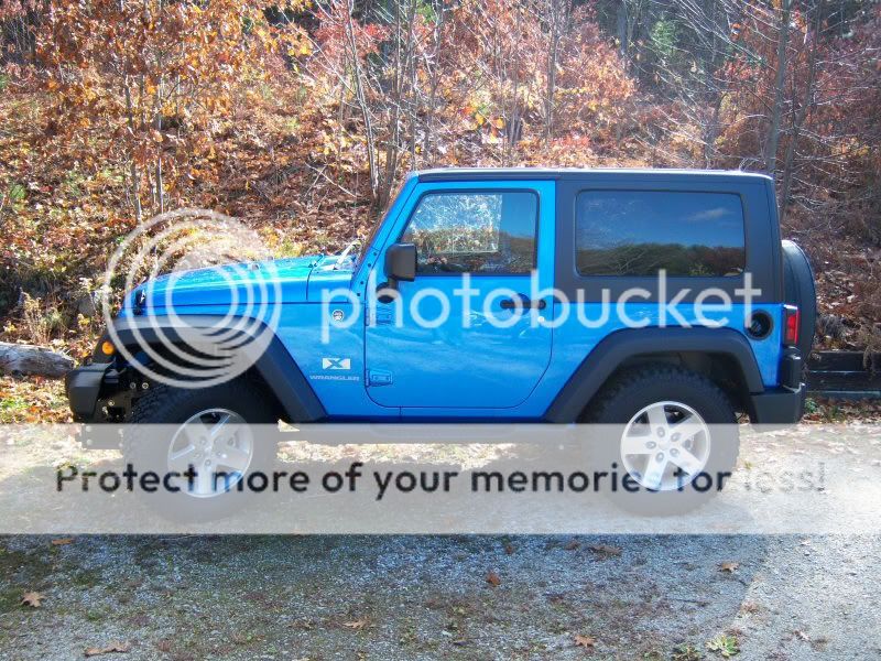

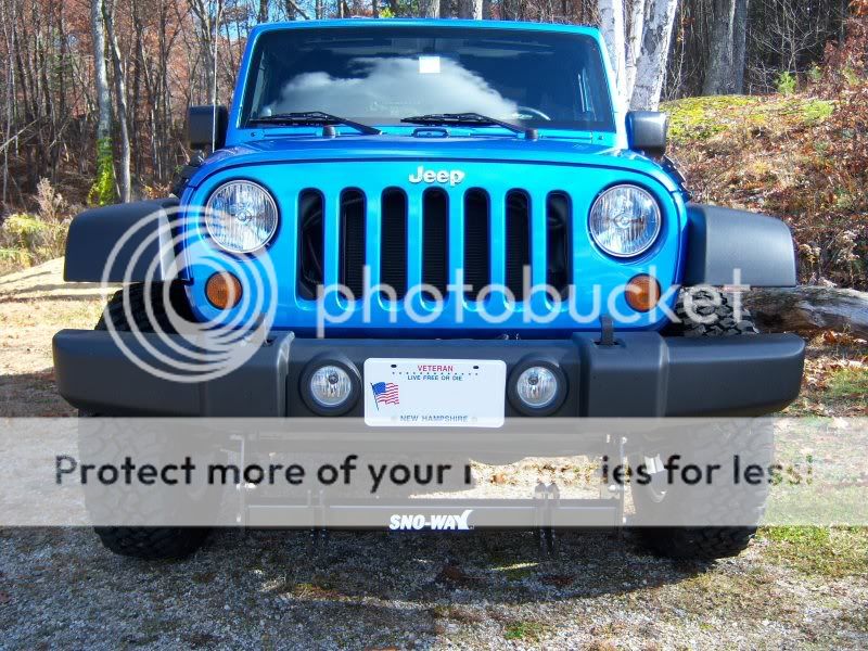

Here's some pictures... I know there not as cool as most of the pictures here, but hey, at least I posted some...
I know what you all are thinking in these next pictures WHY?
Well, because I needed something with a short wheel base to plow with!
Swagger is offline

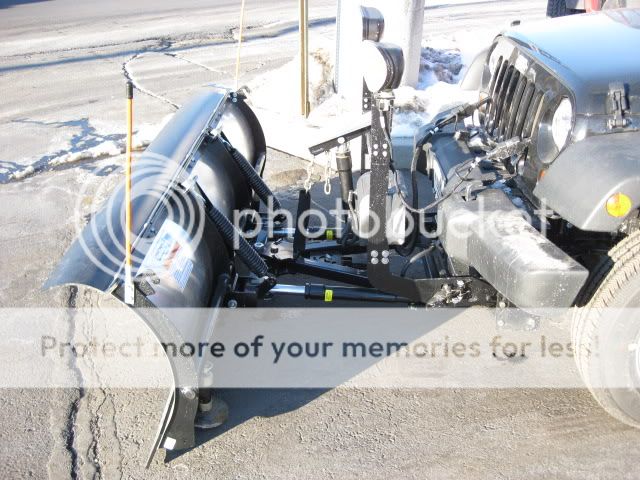

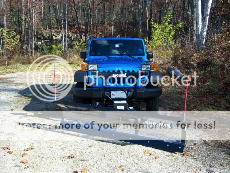

Hello! As you can see from the last post, My Sno-way 22 series plow and mount comes off as one unit. Sno-way plows are one of the lightest plows out there. They also use an active down pressure system for front plowing and back dragging. This inturn down pressure system will help with the traction some. The thing you must remind yourself is that you are useing a jeep! So no plowing 12" of wet/heavy snow at one time! If you are careful in how you are plowing, there is no more wear than you would get from heavy wheeling. You just have to take your time...

Well, it can not plow like a one ton... Unless you have a Hemi set up with 60 D axles with a couple thousand pounds extra in the rear-end. Or you can start plowing a little earlier will 5” or 6” of snow at a time as to not kill your rig. Sure you can plow 12” of snow if you want to replace your front end after everything falls off!
I needed the short wheel base to be able to maneuver turns and smaller areas in my driveway. My drive way is like a spider web, going around cabins and the main building.
