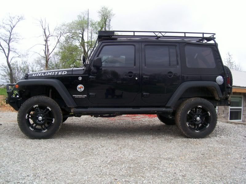

I added a Smittybilt bumper and winch but front dropped less than half an inch so I'm looking to put 3/4" coil spacer on to bring level.

Flylrd, I think I am in love with those sweet, sweet wheels. Where did you get those????
