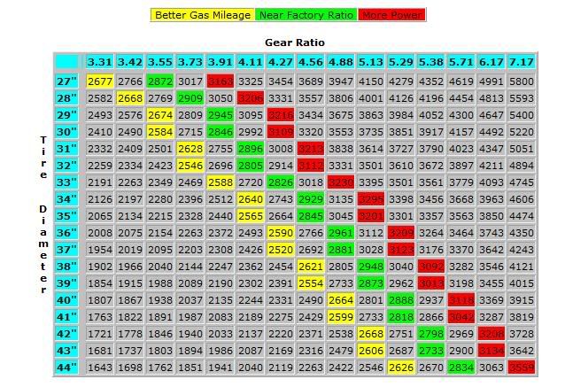

Does this help

yeah the graph is what actaully got me thinking 5.13 but i wanted to hear some first hand feed back.

Originally Posted by Jerzjeep View Post
Does this help
So according to this the stock 3.73 gears are not even in the factoty range with stock tires?How f'n lame.
