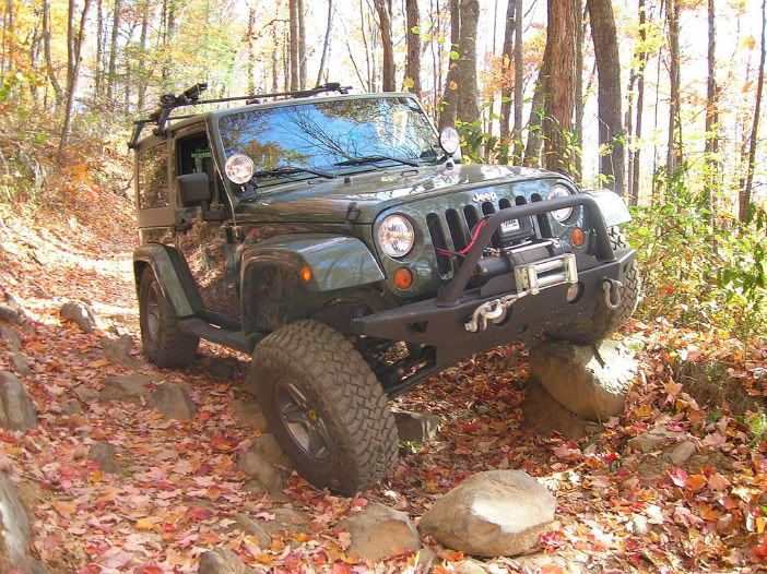

without a real lift and gears, 35's will be more of a burden than a benefit.
This is my rig with 33's fully tucked. I have about a 2" net lift after my bumpers and winch.

^^^ Nice, looking like with proper backspacing and lift you can dial in 35's with the clearence you still have.
Thanks for the pic your tire size and advice .
So looks like to get the tire size I want I'd need at least a 3" lift, 2nd set of rims, a bumper that isn't sunk so far into the fender (i'd think even tricked919 33's would rub the stock bumper if he still had it) and gears.
