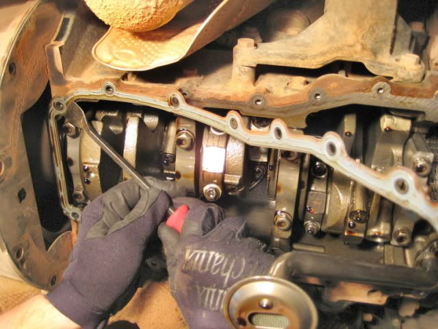

I don't think there is a splash tang on the bottom end of the JK 3.8L engine.
There is a hole on the major thrust side of the rod's big end to lube that side of the cylinder wall. Any other splash oil is from what squeezes out of the rod bearings.
Picture of the bottom end of the JK 3.8:

Roger that and thanks. I have been out of the machine shop long enough to not have laid hands on a 3.8 so had no reference.
Even with positive spray though the splash cooling and lubricity reduces as oil level goes down (less oil means more aeration and contaminates "per capita"). And with reduction of oil volume, heat accumulation (same heat load spread over less oil) and resultant surface heat increases still holds true! And keep in mind a tang does not dip into the sump - it only directs where the bearing bleedoff slings! From an engineering perspective (which always must balance manufacture time, cost of both part and machine tooling and function) when ever you see positive feeders you must realize that added machining step and cost are there for a reason - usually higher piston and skirt temps, secondly deeper piston undersides (where sling just don't make it to the wrist pins).
The positive does slow the acceleration of splash loss with level drop significantly though as a posi just means more total volume to the bottoms - but can be argued that as that total is now more critical - reductions are now more detrimental! Unless there is a windage and scraper - in which case the positive is the only oil that the piston sees so total oil present remains constant until the pump sucks air.
When you mentioned a tang on the rod for slinging oil, the only thing I could picture is the only type of tang I had ever seen on an engine: one that dips into the sump.
What are the tangs you were referencing? Got a picture or a link?
(The JK 3.8 pistons have very short skirts.)

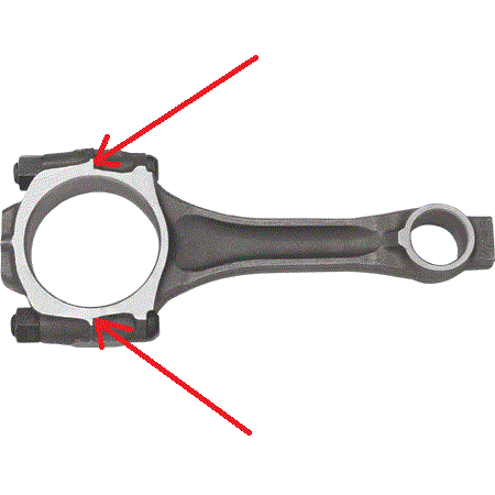

The 2nd generation Small Block Chevy is a prime example of tanged connecting rod (pic below). If you look at the machined surface at the parting line of the cap and rod you can clearly see the step tang. The tang DOES NOT DIP. In order to dip the oil level would have to be so high that the crank ran thru oil (the tang is halfway up the rod journal) - and doing so would kill the slinging effect as the oil wants to stick to itself (one of the reasons overfilling is bad)! This is obviously not the case as the front of the chevy pan is "dry" that is all the oil there runs back into the sump. But what happens is the oil that flows off the bearing and out the sides (bleedoff) is slung by the tang upward to the piston bottom. Oldsmobile rods have an elongated tang for better direction control. ANd typivally oil level is two inches below the farthest arc of the rotating mass - the helps eliminate parasitc losses (engine working to run thru gobs of excess oil is less power avail at the crank end).
As the skirts on the 3.8 are short - obviously the extra oil being sent up there from a positive squirt is for cooling the bottoms - not so much lubing the wrist pin. This makes sense as with computer controls we are running closer to (and even right at) stoichiometric (14:1 air fuel ratio) vs carbs which we tend to run at less than for a safety margin (sometimes at 12:1 afr). Pistons run hotter in todays engines than in the builds of the past - especially when equipped with knock sensor!
The pic I just added shows another way to direct the bleedoff - straight up it's own rod! this is a straight six where one side can not splash the other.

I knew the rods don't dip into the oil. The tang I was thinking of was one that hangs down from the bottom of the rod cap, and does dip into the oil. That's why your reference to a tang brought me to an incorrect mental picture.
The forced oil from the hole in the JK 3.8 rod is mainly to lube the major thrust side of the cylinder/piston.
Are the arrows in the picture pointing to the "step tang" you are talking about? If so, I had no idea that's what it was for.
I can see where the slot in your second picture would be good for cooling the piston bottom, and lubing the pin.

The top arrow is the splash tang. The bottom step is balancing it weight wise (and thus not as pronounced). I have seen older Buick and Pontiacs where that thing is as wide as the outer edge of the casting. This is one reason it is so important to make sure you have the right orientation on the rods. If you hang em backwards it slings oil away from the opposing piston bank. The other of course being the chamfer - if backwards the chamfers are together and oil is bled off between the rods instead of at the crank side, lowering the pressure at the bearing and over heating the crank at the journal radius.
