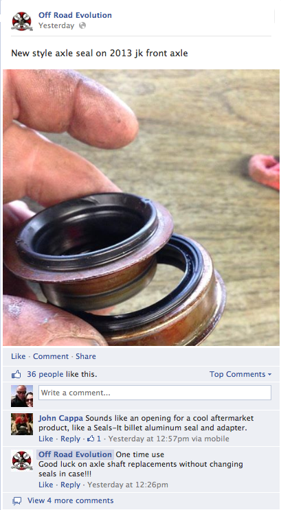

So I recently just saw this post on Facebook by Evo. Apparently on the 2013s you can't change a front shaft without replacing the inner seal

What are the particulars? Does the seal fail when the axle shaft is pulled out?

I just picked up a '13 (JKUR 10A)... I'm trying to think this through... On my 2010, it was a pretty straight forward install, and all parts came with the purchase from Tom Woods. I do remember having to remove the OEM flange (from both the diff and t-case output) and using the one supplied by Tom Woods. In Evo's install, did it require replacing the OEM flange? Was it that the new flange didn't fit through the existing seal (*edit*.. duh.. it HAS to fit.. if it didn't, it wouldn't fit into the carrier.. never mind on this question**) and now needs to find the right size seal? Or did the seal come off when removing the flange? If it came off, was it because it was "seated" in the flange itself? Or was the pinion seal not installed correctly from the factory and it just fell off?
Sorry for the barrage of questions.. I'm in the process of doing research for the build and budget timeline for the new Jeep.. Thanks!!
*edit, again* - It must be past my bed time.. those seals are from the axle shaft.. geez.. for whatever reason, I jumped right to the drive shaft.. never mind on the drive shaft.. but that SUCKS about the axle shafts..

I can't see it working that way anyhow, I'm interested in searching the EVO site.

I'm surprised no one has chimed in saying they've changed a shaft on a 13

It's going to really suck if I have to pull the differential when I install Nitro shafts.

I couldn't find anything about 13' axle shafts except for the fact that the u-joints are beefier. No mention of having to change out seals with the shafts.

Just ordered some chromoly shafts for my 2013. Has anybody done this yet? are seals a problem?

When I was talking to AEV a couple weeks ago, the rep was saying they haven't been experiencing any issues with changing the front shafts on the 2013's. You just need to take it easy when installing the new shafts. The seals will tear super easy. At least thats from what I'm hearing.
