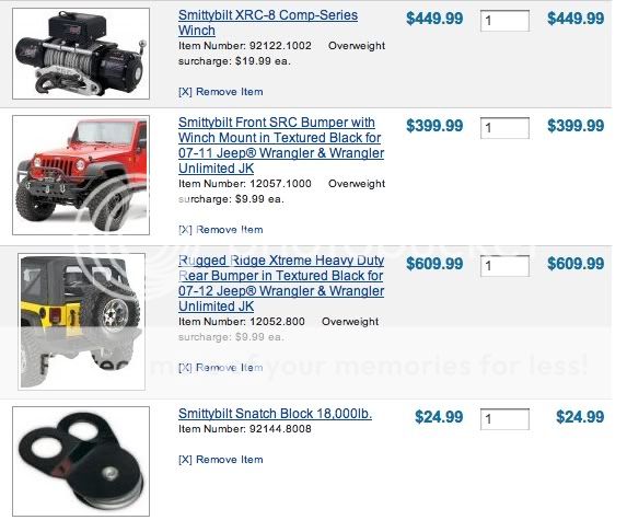

So here is what I'm thinking of ordering. Any comments? I really like the XHD front bumper but with the pre runner she is really pricey. The SB has the same look but is much cheaper. Any thoughts on the SRC?
Also, I'm planning on getting a tire carrier for the rear bumper and am thinking of going with the RR tire carrier. Any thoughts? Am I crazy going with a 8,000 LB winch and thinking a snatch block will make up for it being on the lighter side? Should I just spend the extra money? I don't wheel hard but I'm willing to put myself in a spot where I need to get winched out. I just want to have a little fun.
I'm pretty sure I'll go with the terra flex 2.5" coil lift with shock extenders. The website says to go with that if you have a RUBI. I'm a little nervous about the lift and bigger tires. I've been reading on the forum and there has been a lot of talk about not being able to regear to 4.88 or 5.13 due to computer problems. Does anyone know if this is possible yet? Also, how much does it usually cost to regear if I were to have a shop like 4wheel parts do it? Would I be able to have 4 wheel parts do the regear, put on the new wheels and tires and then drive it home and I can put on the lift kit myself? I'm not sure if 35's will fit with no lift for a drive on the highway.

I donít have any personal experience with those bumpers but Iím sure others will chime in and give you their thoughts.
As far as the winch goes 8000 is probable acceptable but if it were me I would go with a 9500 instead. Winching is not something that you should skimp on. Sure, a snatch block will work but do you really want to go through the extra work rigging it up? Also it will shorten the reachable length of whatever you plan hooking up to.
