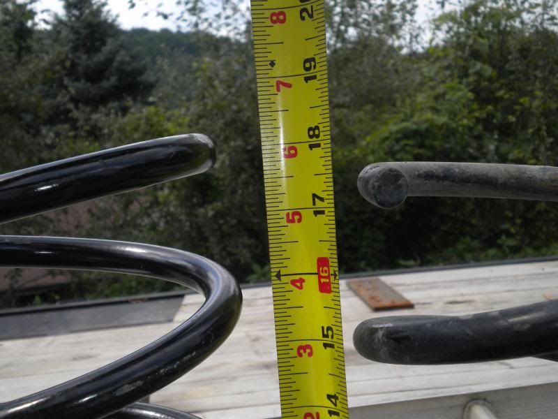

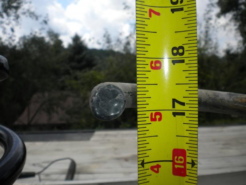

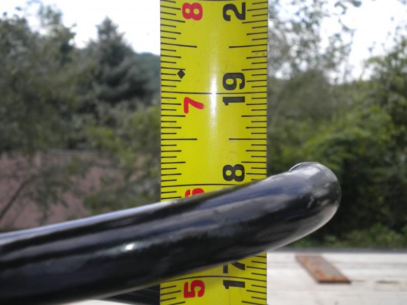

Like was just mentioned in the previous posts, the coils are NOT the same length.
Unfortunately, I threw my stock 13/55 coils out and can't get a measurement or picture of them, BUT here is a comparison between a 16 and an 18 front coil spring. I'll get more measurements as I round up different coils.
Stock 16 coils: 17 1/2"
Stock 18 coils: 18 1/4"
52126218AC: 18 1/4"
52126216AC: 17 1/2"
Side by side comparison of a 16 and an 18 front coil spring
There is roughly a 3/4" difference between the 16's and 18's.
If the spring heights are consistent, there would be atleast a 1 1/2" (if not slightly more) difference in height between the 13's and the 18's.

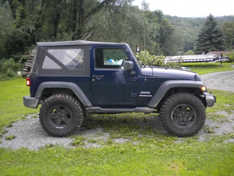

18/60 coils, 1.25" wheel spacers and 35x12.50R17 Goodyear MTR/K.
