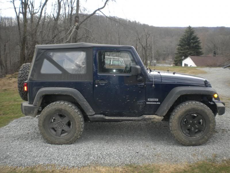

The Jeep is a 2013 2 door with a soft top and 285/75R17 Dunlop Fierce Attitude MT's. There is about 1,100 miles on the Jeep, so the stock 13/55 coils are not wore out or saging and the only added weight is the matching 285 spare. I swaped from the stock 13/55 coils to a set of 18/60 coils (planned on 18/59s but ended up with 18/60s).

I gained 1.5" lift in the front and 2" in the rear.

BEFORE: (with stock 225 tires and 16" steel wheels)
AFTER: 18/60 Coil swap and 285's on JK 17" wheels with 1.25" wheel spacer.
