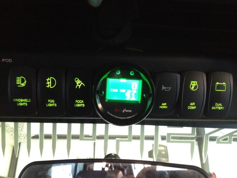

HAHAHA
Its just a space filler. the three red switches dont do anything right now.
I need to order new switches and rockers to match my sPod ones.
It will have:
Arb compressor
Front Locker
Rear Locker
Driver seat heater
Pass seat heater
AUX dome light
Looking to sell the gauge if you arent using it anymore?
