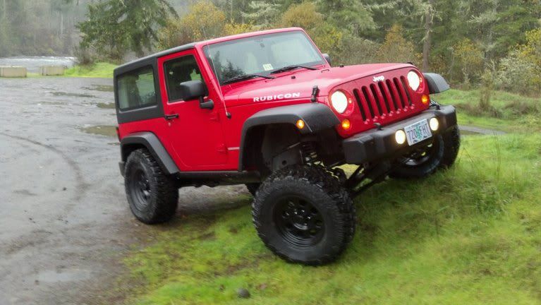

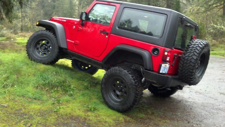

Got the lift installed yesterday, didn't take any during pictures, but I have before and after pictures.
The stock shocks would not fit at all so I drove it home on all surface streets while dealing with the bouncy ride. I do need to center the steering wheel to prevent the ESP from activating on slight left turns.
I do have on question though... I've heard that the 3.5" lift is conservative in the amount that it lifts the Jeep, but I think RK might have sent me the wrong springs, I netted 5.7" of lift in the front and 4.6" in the rear. Does this sound right for a 2 door? My front stock springs where 14's and the rears where 56's.

It is not unusual to have a bit more lift and then the rig settles after a while. The amount you mention though is not in that range. Have you verified the spring's part# with the shop?

Wow, that is a lot of lift, it still looks great though.. Is there a part number on the coils that you can check to see if it's right?

The part numbers on the springs match the RK web site for the 3.5" springs. Maybe my rig in unusually light compared to others.

I would say that the advertised numbers are based on an Unlimited JK. A 2 door JK will get about 1" more lift from the same springs as a 4 door. Your stock light weight bumpers are also a factor to consider.
Given time for settling and the addition of bumpers and winch it should end up within the assumed range of about 4-1/2".

From the looks of the picture of the front fender clearance you got about the same lift I did with my 3.5" from RK. Looks good!
{edit} I didn't take measurements before I did it so I'm afraid I don't have anything to compare to, I'll measure where it sits now next chance I get and include tire size so that should give you a pretty good idea

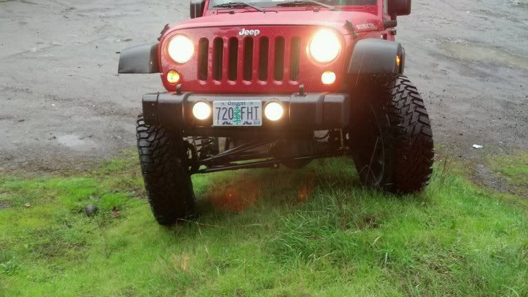

Had a chance to flex it a little, not enough to fully stuff the tires though, still had about 3" of up travel left in it.
Looks like I'm going to have rear bump stop issues on the passenger side though.

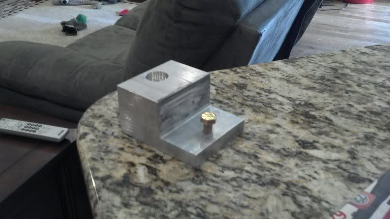

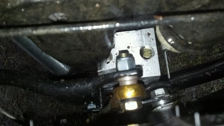

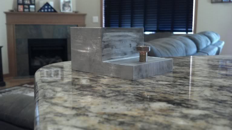

Created my own fix for the RK lower bump stop thanks to my local machine shop since I don't have the equipment to make a nice cut like this.

Nice... FWIW, with my 3.5" RK, I opted for the Pro-Comp "install" kit. I didn't use all the parts, but did use the bump stop extensions (not really an "extension", but mounts on the surface to limit the travel) and the rear track bar relocation bracket. The bracket that came with my RK required welding, while the ProComp is a bolt-on design.
Put the RK one on and have it welded. Bolts shear, plus the factory bracket is too weak to handle the added stress of the additional flex, it will bend or break under the bolt on. The RK bracket bolts on also, in the install instructions it just says have it welded before you wheel it hard
