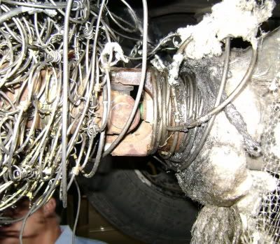

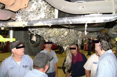

Make sure you haven't picked up something on your drive shaft.
wow!
skivviss is offline
post #8 of 19 Old 07-28-2010, 09:52 AM
Tireguy
2009 JK Wrangler
Location: Land of Lincoln
Posts: 235
I have that same email...that WAS a mattress. Now its just a little counterweight.
