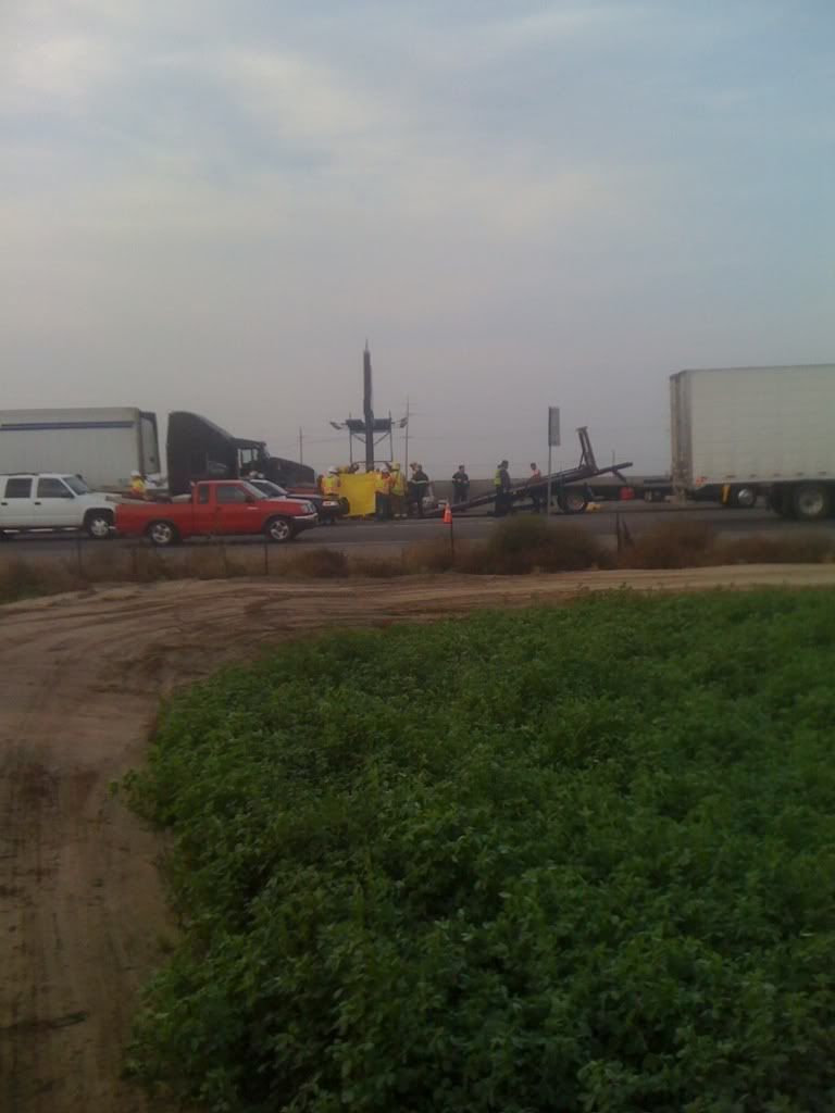

And a simple fender bender turned decapitation.
