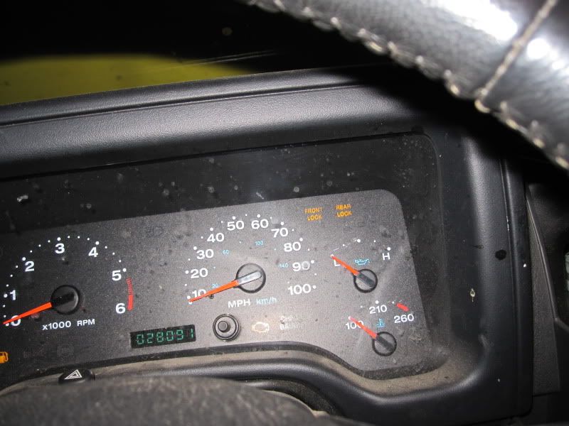

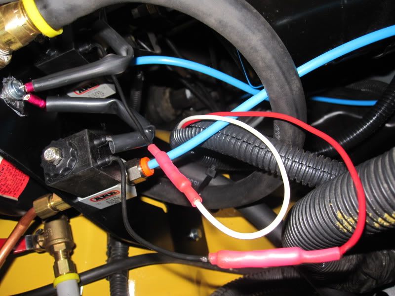

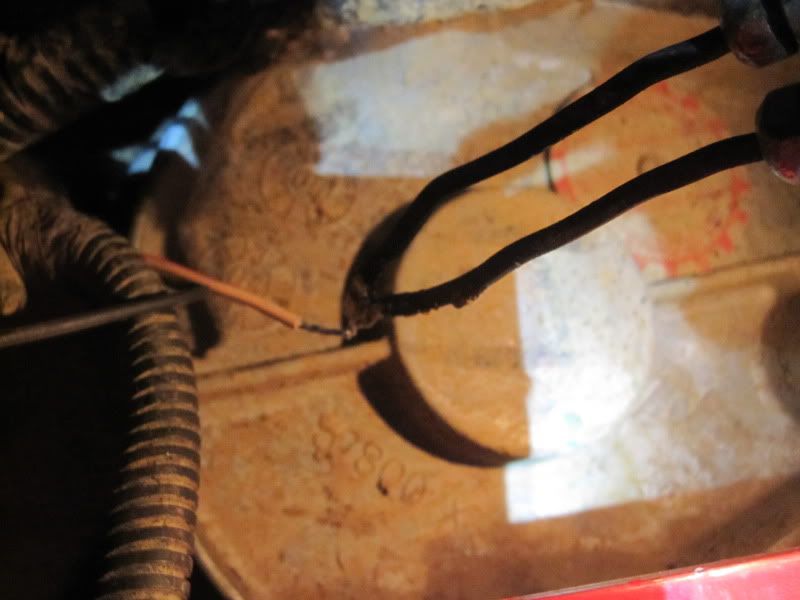

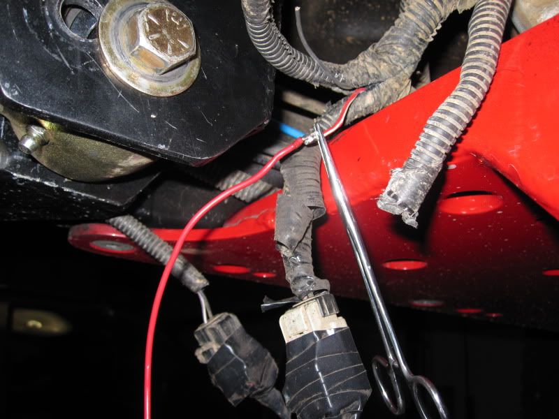

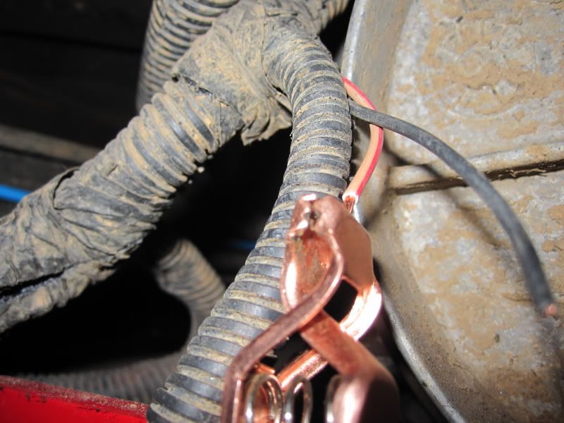

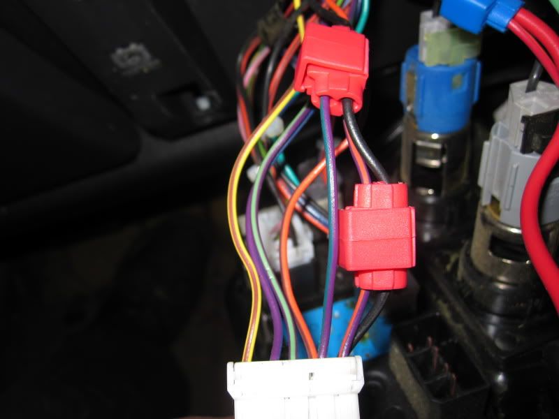

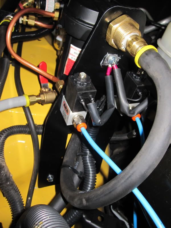

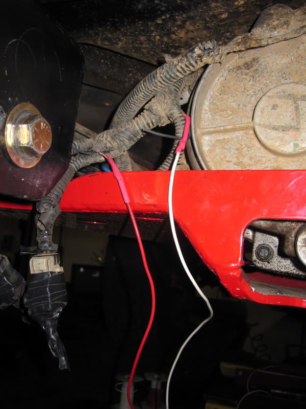

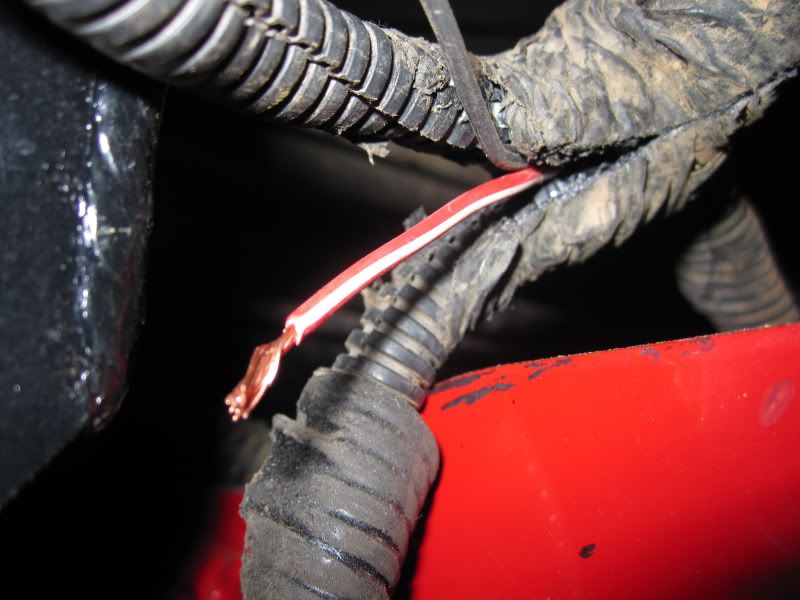

finished up locker wiring this morning, I use the factory Rubicon locker switch to activate the ARB solonoids...
determined which wire was front/rear..
Front
Rear
solder/shrink wrap all conections
mod the switch to work at any time... wires 1,4,and 5 get scotch locked together.. I did not include a relay to prevent the dash indicator lights from flashing, I feel it's eye catching when they flash and won't be easy to forget.

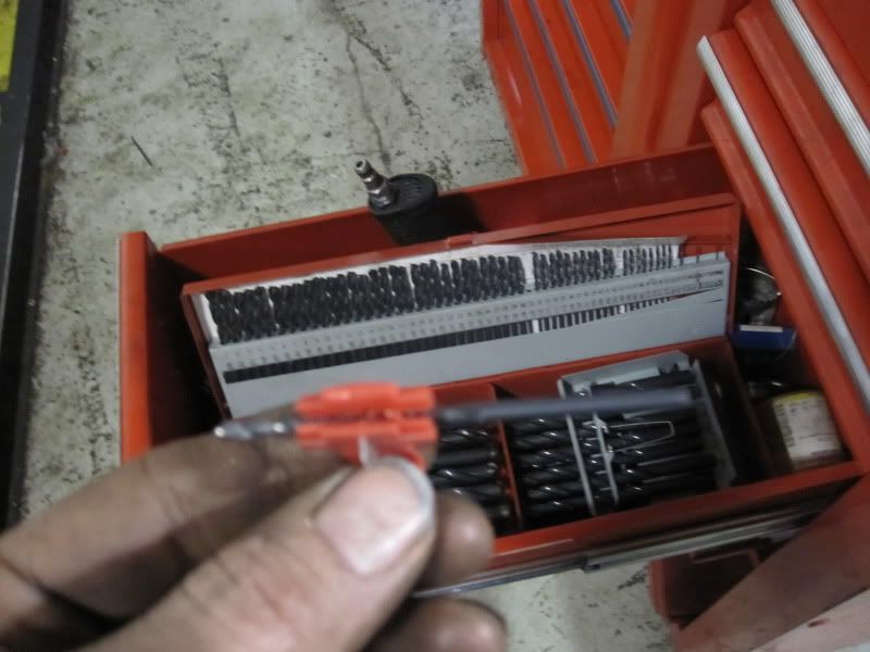

On a side note, that's a nice drill bit set there.

medical forceps (Kelly hemostat to be more precise)...great idea....I need to buy some now
nice set of Jobber bits too...I need to buy a set Don't you hate breaking those #50-60's?

LOL, the bits are the cheapo harbor freight... I pretty much only use them to drill valve body plates/valve body cross drills when doing automatic tranny shift kits, even the big ones bust really easily if you push on them to hard. of course my 1/2" snap-on air drill is stronger than a big 1/2" drive electric, so that doesn't help much either.
how do those HSS HF's work for you? The cheapo HF TiN's I've used would barely cut aluminum...course I was comparing them to a Made In USA set of Cobalts.
nice work on CB3's rib btw...can't wait to see it finished & painted.
they work fine as long as I don't spin em too fast or push on em...
