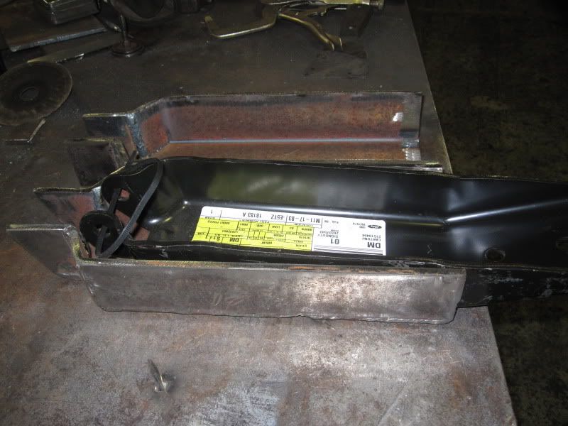

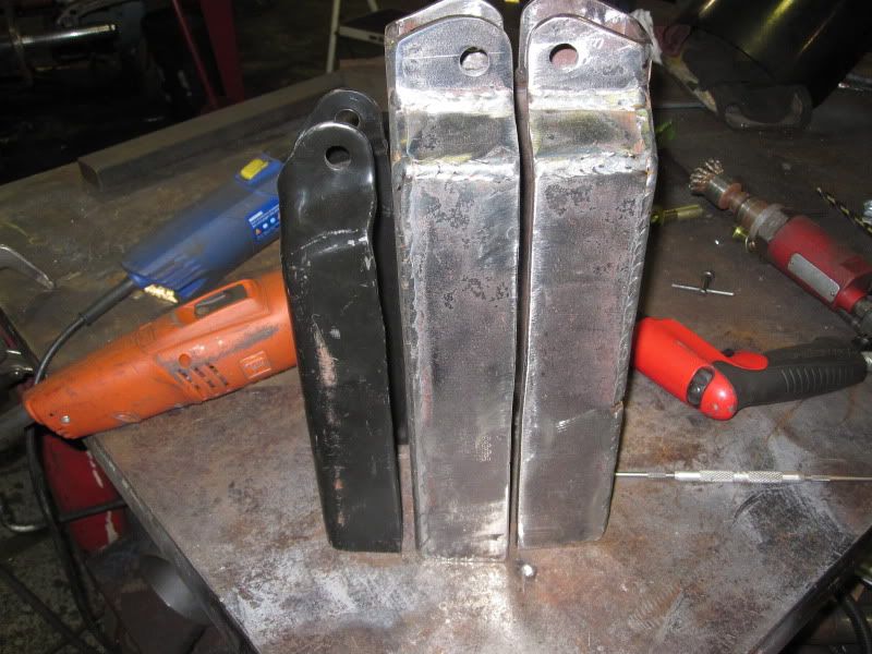

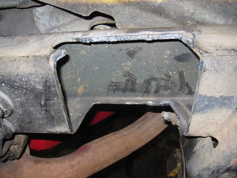

so they are steel & not aluminum?
I've got a set of 1/8" steel Poison Spyder Customs I got super cheap when they closed in CO...been wondering what to do with them...
Did you seal them off, weld them on, or what?
Yep Steel, and they are more than sealed with Right-Stuff silicone, I pitty the person that tries to get them off one of these days.....

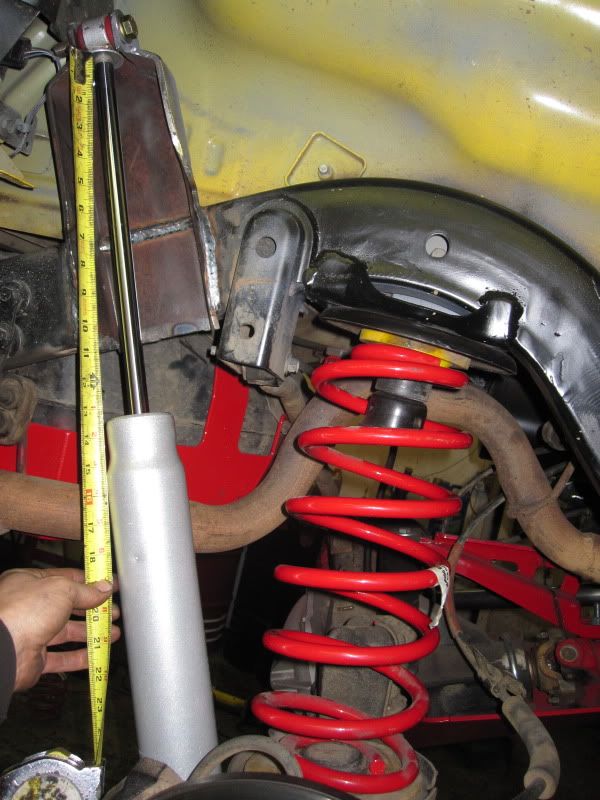

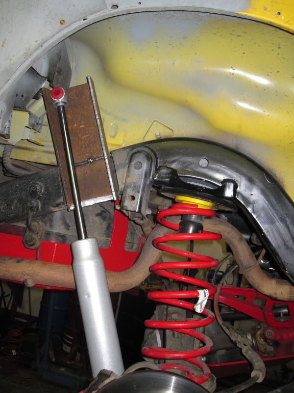

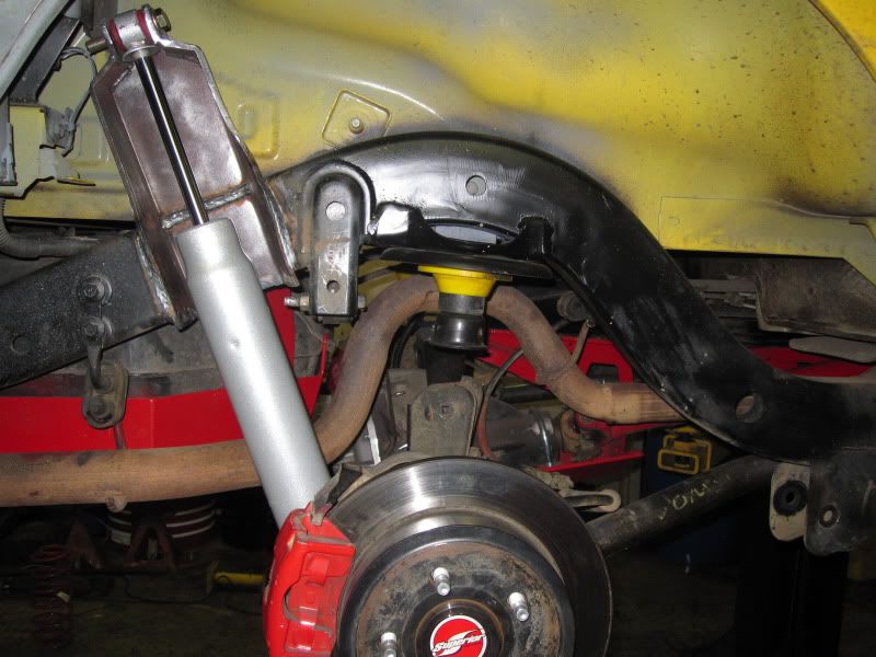

Originally Posted by Bennettj13 View Post
With 6" of uptravel what do the upper shock mounts look like?
they are stock, I lowered and moved out the lower mounts for the nearly 12" travel front shocks. moving them out a little kept them from hitting the frame fully articulated. the rear are 13"

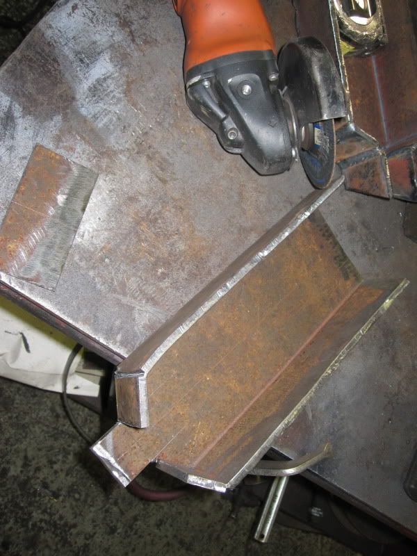

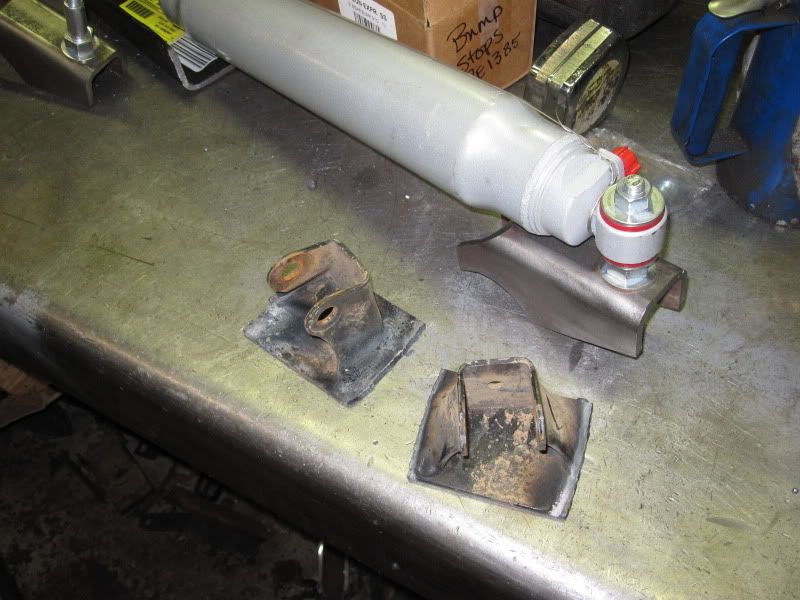

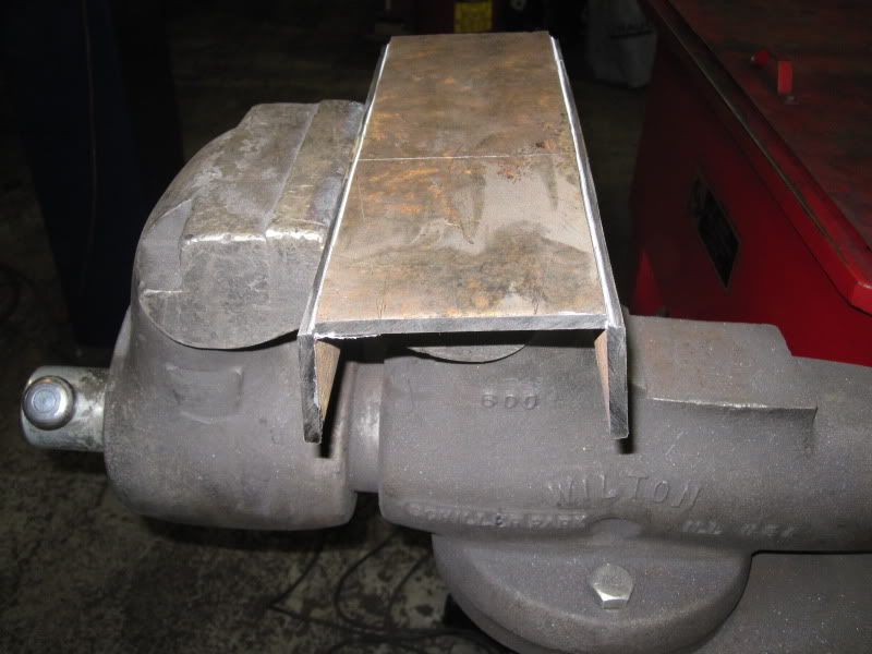

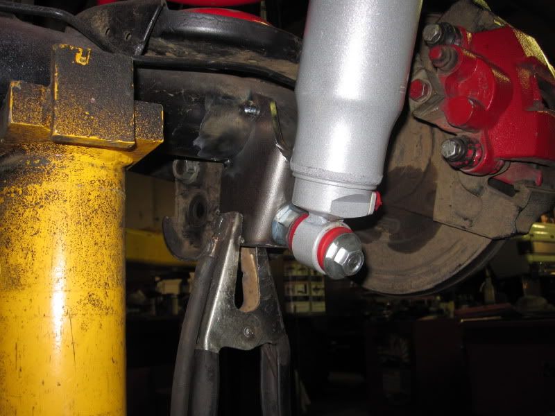

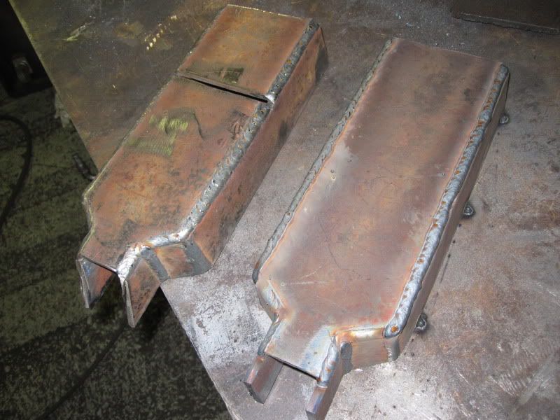

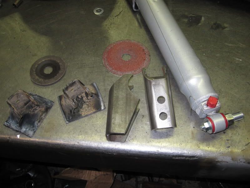

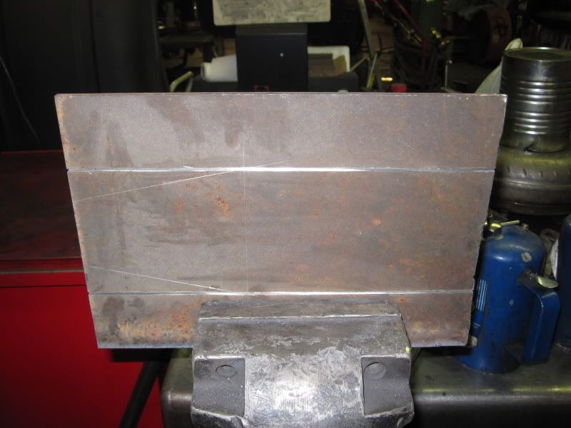

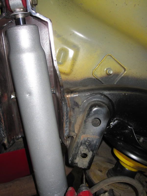

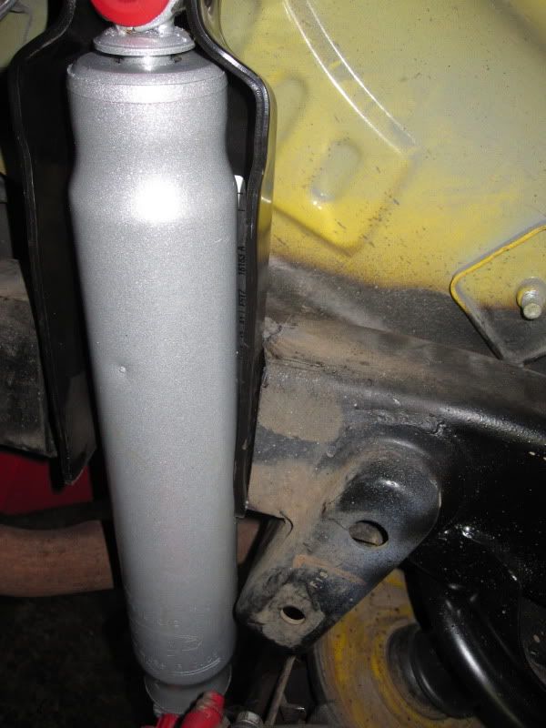

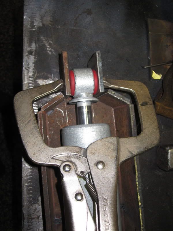

got a little more mock up done today, The Van conversion is finally done and shipped out today, so I'll have more time for it...
The ford towers are a couple inches short of working with the 2.5" springs and rancho RS999012 13" travel shocks. I had originally made the lower mount so they would and decided they hung down to low. so I'm making them from plat steel.

post #21 of 117 Old 03-01-2011, 09:10 PM
rkwfxd
Posts: 584
Single sheer? With a custom mount?

Posts: 5,999
we'll see..... this is how I did mine several years ago....
