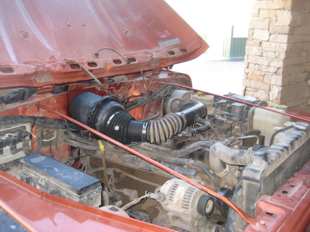

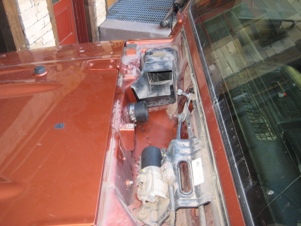

I finished mine last week. I found I did not need a reducing elbow, I cut the bellows off the stock tube, flipped it 180* and re-attached it. It fit perfectly to the Windstar box.
I wasn't sure how to finish inside the cowl. I never had that horn shaped thing mentioned earlier. Here is what I did, any thoughts?
