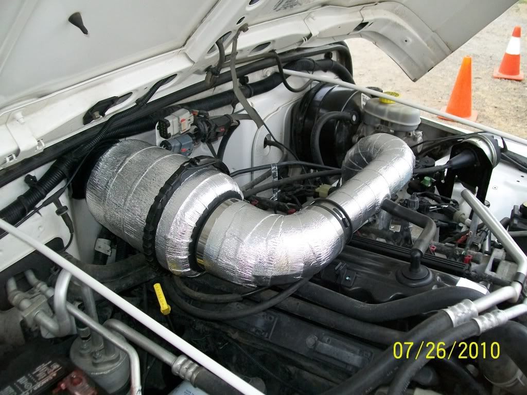

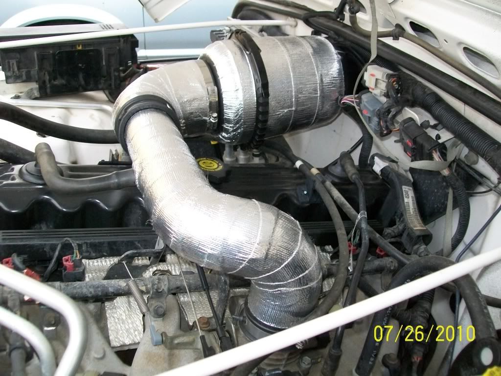

i finally got the intake wrapped i used thermo tec thermo shield it was pretty easy to do just time consuming cause i didnt wrap the sections with one continuous piece i just used strips and put the seme on the back side so its not noticable.
so tell me what you guys think
Any updates on how this is working for you? How is the thermo tec thermo shield holding up? Can you use the oil dipstick very easy?
Can't comment on the thermo shield as I didn't wrap mine, but can tell you no problem accessing dipsticks.

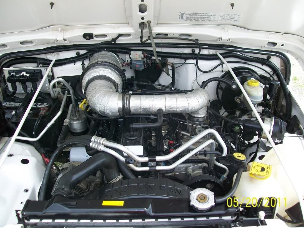

That's one clean engine bay. Has this vehicle ever been off the pavement?
not really just to the river in the summer other than that really dont have the time to do anything with it and im trying to sell it so i dont off road it at all. look at the engine bay after i detailed it

Posts: 158
its working great havent had a single problem with it the tape is staying on just fine besides on the back part of the filter box, air going by it is starting to pull it up but im just going to get some glue and glue it back down. but other then that no complaints and i just drove from northern california to southern washington and got 21.26 going up and 20.62 coming home. and i have no problems with the dipstick and didnt do anything to it.
